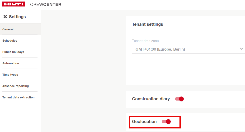

To enable the Geolocation feature Admin has to:
  1. Open Settings
  2. Go to General
  3. Turn Geolocation ON

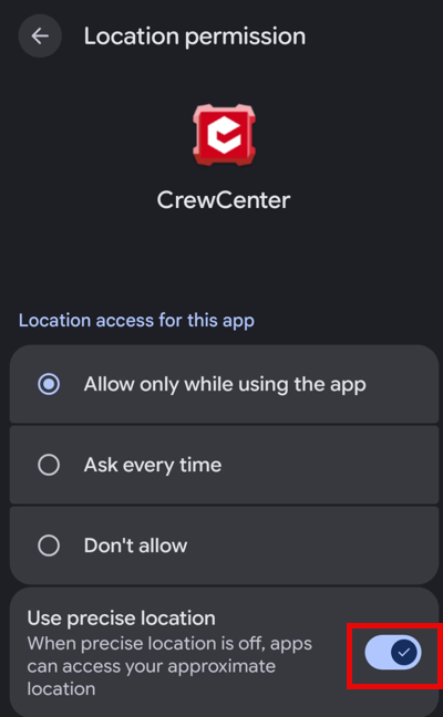

How to Enable Location Permissions on Android device
  1. Open your device settings.
  2. Select Apps
  3. Find the CrewCenter app in your list of installed apps.
  4. Tap on Permissions or Location.
  5. Select "Allow" or "Allow only while using the app" to enable location access. Ensure the presise location is toggled on.

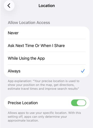

How to Enable Location Permissions on iOS device
  2. Scroll down and select Apps
  4. Tap on “Location”
  5. Select "Always" (recommended) or "While Using the App". Ensure the precise location is toggled on.

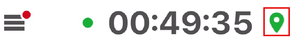

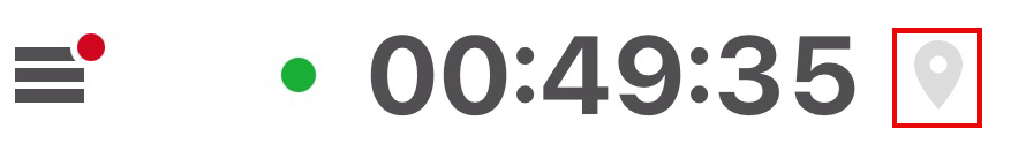

How to check if location is enabled
There is a simple indicator to check whether location tracking is active.
When the user sees a grey location pin, it means that the location is not being tracked.
When the user sees a green location pin, it means that location tracking is active.

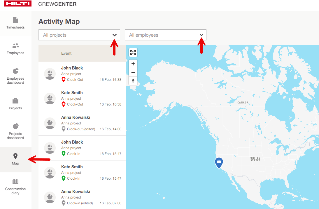

Reviewing Employee Locations as an Admin (Web)
Admins can review employee Clock-In and Clock-Out locations in the web application:
  1. Log in to CrewCenter Web.
  2. Select Map from the left-hand menu.
  3. Choose the desired Project and Employee to view their Clock-In and Clock-Out locations.
  4. If no filters are selected, all project and employee data will be visible.
  5. Clock-In locations appear as green icons, and Clock-Out locations appear as red icons.

How to check if the tracking location is active
If the user has enabled all required permissions and still sees the grey location pin, meaning that the location is not being tracked, they should reset the device’s location settings and re‑enable permissions.
