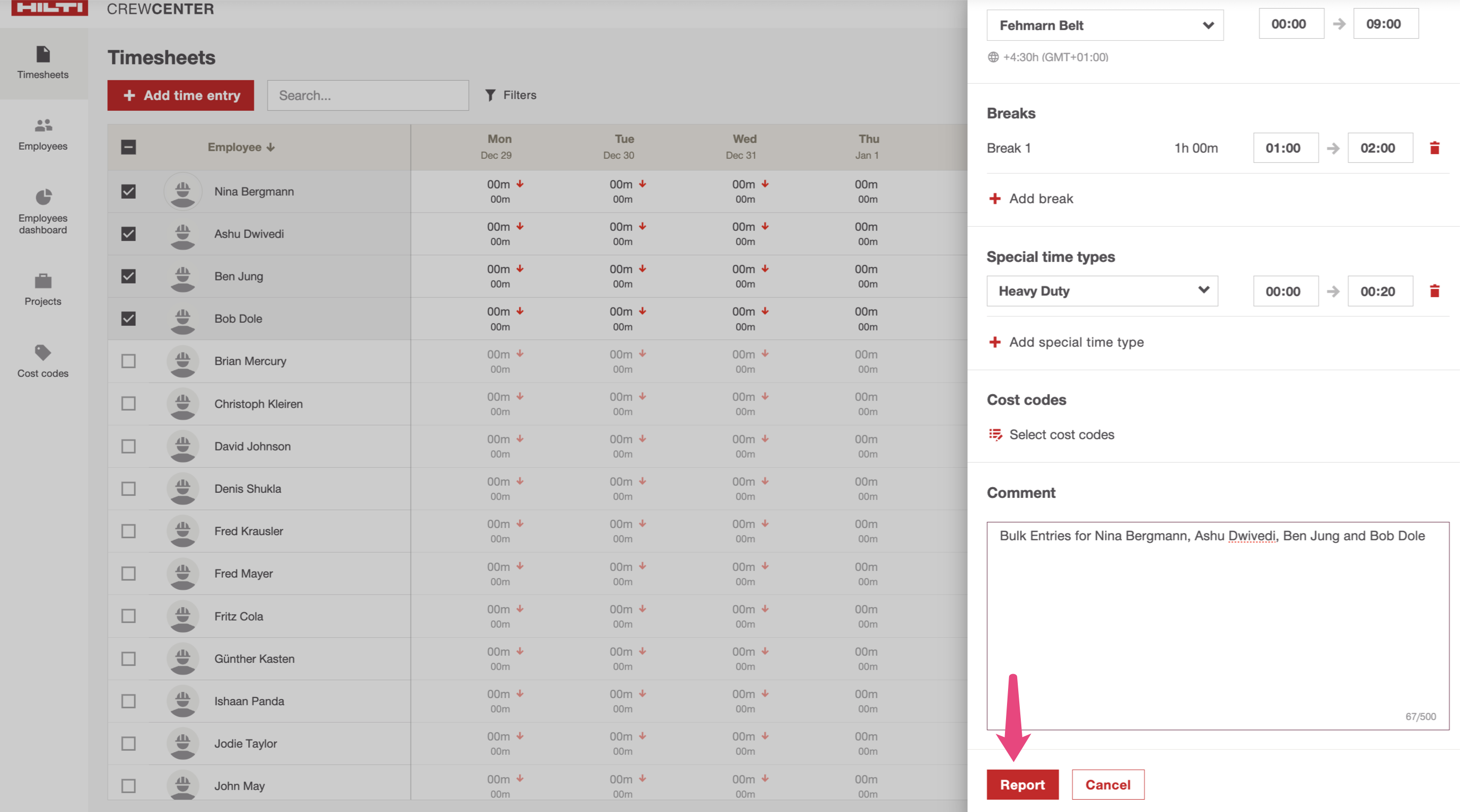

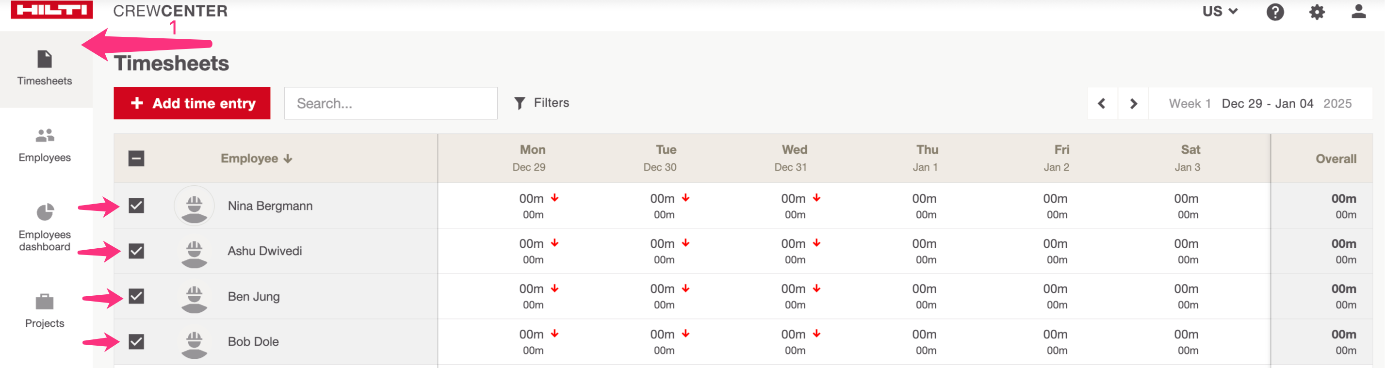

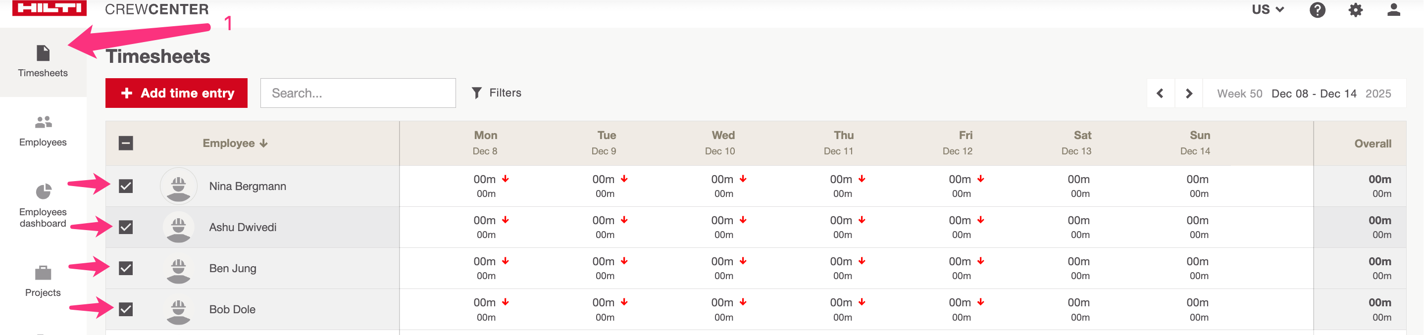

  1. Open CrewCenter Web and navigate to Timesheets
  2. Use the Employee selection (checkboxes) to select:
    1. One employee, or
    2. Multiple employees.
3. Click on '+ Add time entry' and select the day(s) you want to add time for and Add work time details-
4. Click on Report
Result:
CrewCenter creates one time card per selected employee and per selected day with the same configuration.

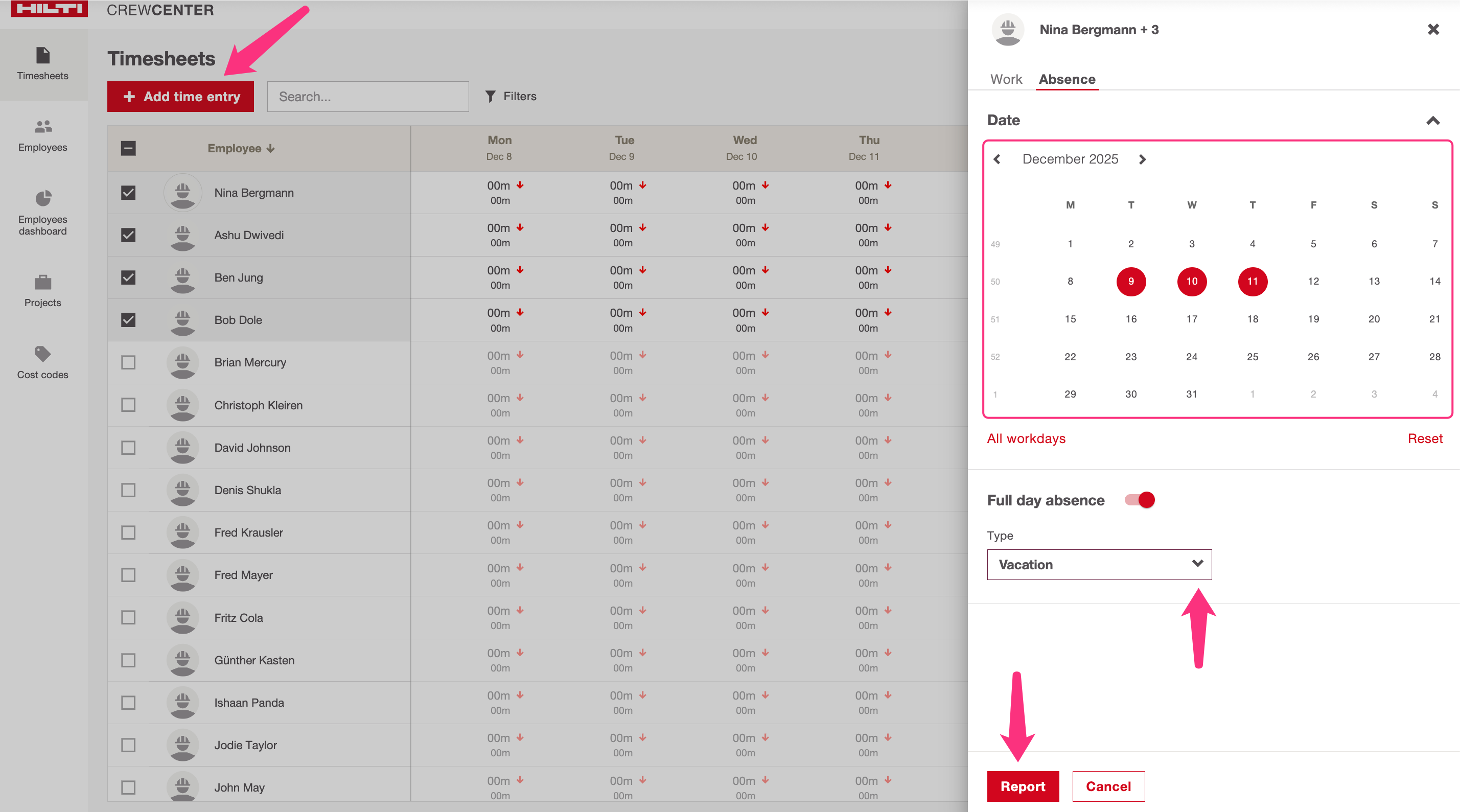

    1. One employee, or
  3. Click on '+ Add time entry' and select the day(s) you want to add absence for and select type of Absence :
  4. Click on Report to confirm.

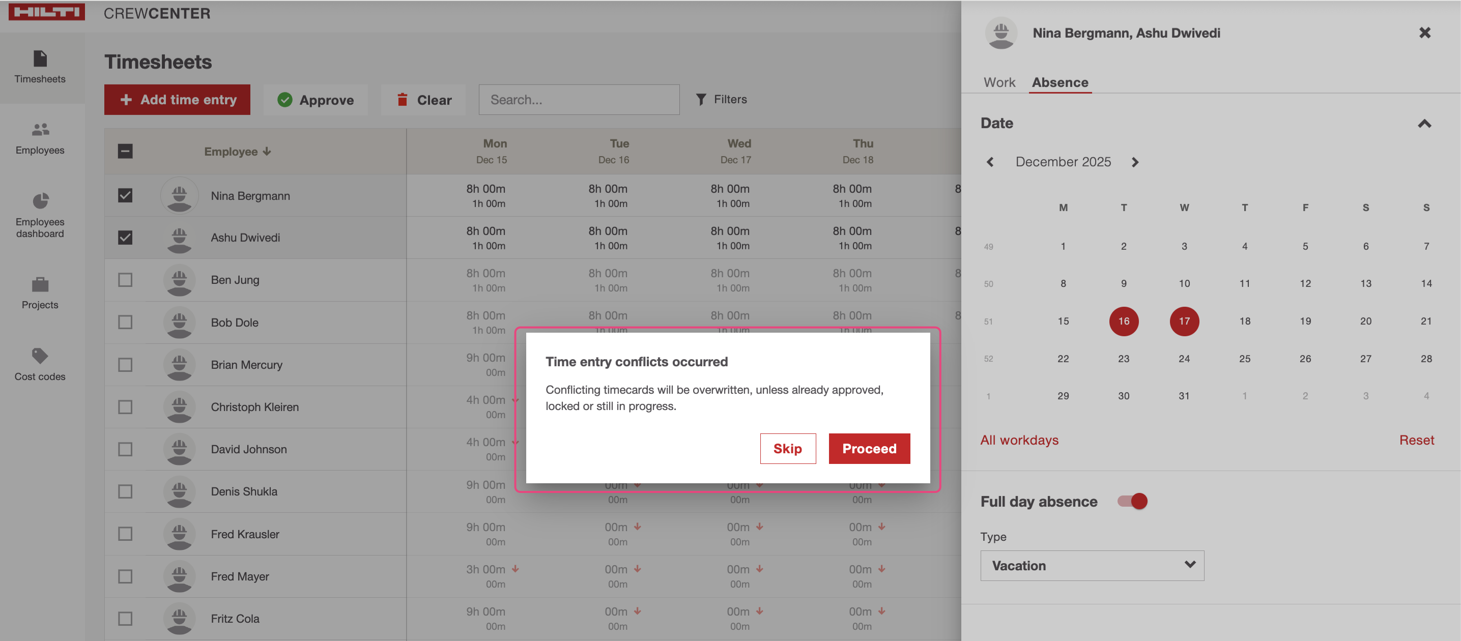

Important Notes:
  • Absences cannot overlap with existing work or other absences without conflict handling (conflicts will be shown, and you can usually choose to overwrite or cancel).

  1. Open CrewCenter Web and navigate to Timesheets.
    1. One employee, or
  3. Click On Approve to approve the timesheet of selected employees.

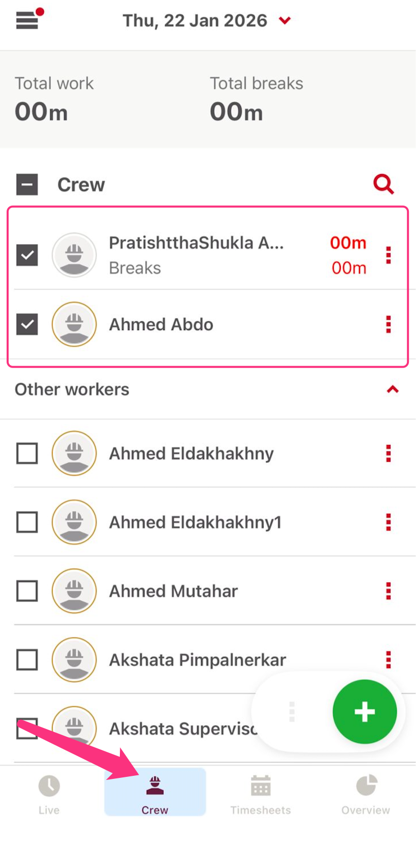

2.1 Bulk Operation from Crew Tab (Multiple Employees)
On Mobile, bulk operations can be used to:
  • Add time (work) for multiple workers at once
  • Add absences
  1. Log in to the CrewCenter Mobile app as Admin or Supervisor.
  2. Navigate to the Crew tab and select Employees.
   3. Click on Green icon '+'

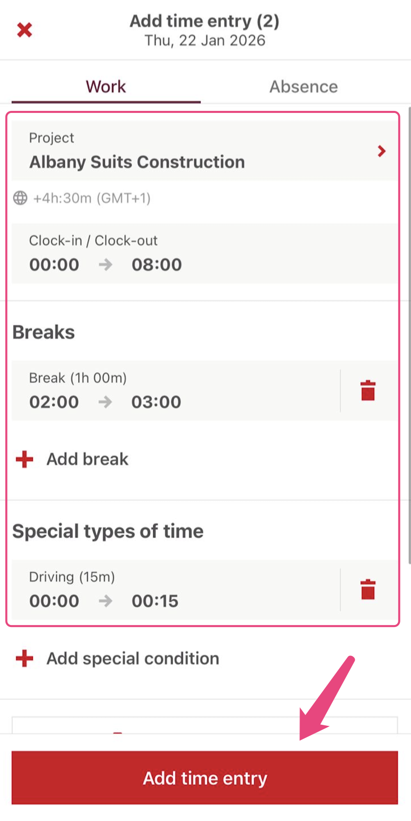

4. Add Time Card details and click on Add Time Entry
5. To Add bulk absences, navigate to Absence tab and Report absence. An absence is created for each selected employee and each selected day in the chosen date range.
