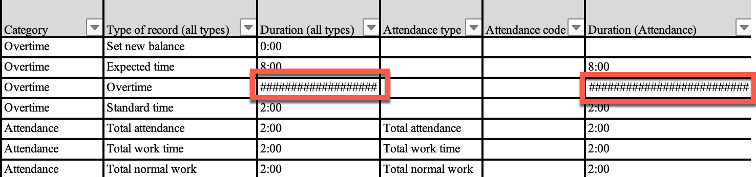

    If your Excel export shows ############################ for time values:
    Some CrewCenter exports contain negative time values, which is expected in real working scenarios. For example, if the required working time is 8 hours and the actual worked time is 2 hours, the resulting balance will be –6 hours.
    The data itself in the document is correct, but Excel is using the wrong date system (Excel  cannot display it properly with the default setting.). To display the values properly, enable the 1904 date system for that specific file and save it.
    That -6:00 value is correct and must stay visible in Excel.

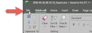

    Once you open the exported Excel file:

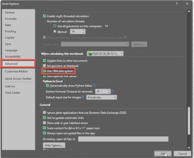

    1. Click File
    2. Click Options
    3. Click Advanced
    4. Scroll to When calculating this workbook
    5. Check Use 1904 date system
    6. Click OK
    7. Save the file

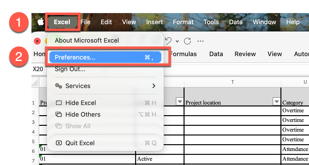

    1. Click Excel in the top menu
    2. Click Preferences

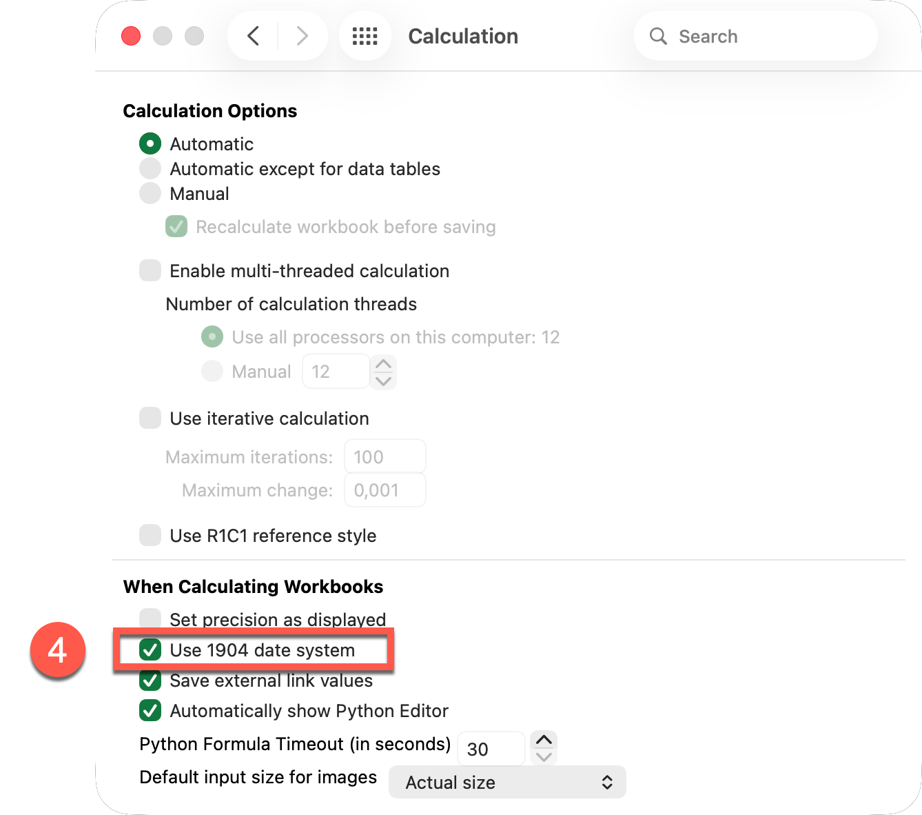

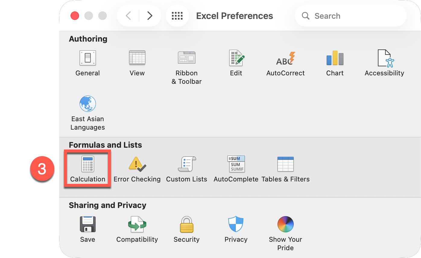

    3. Click Calculation
    4. Scroll down to "When Calculating Workbooks" options and check Use 1904 date system
    5. Close the settings window
    6. Save the file (If the document is not saved, the process will need to be repeated the next time the document is opened.)
