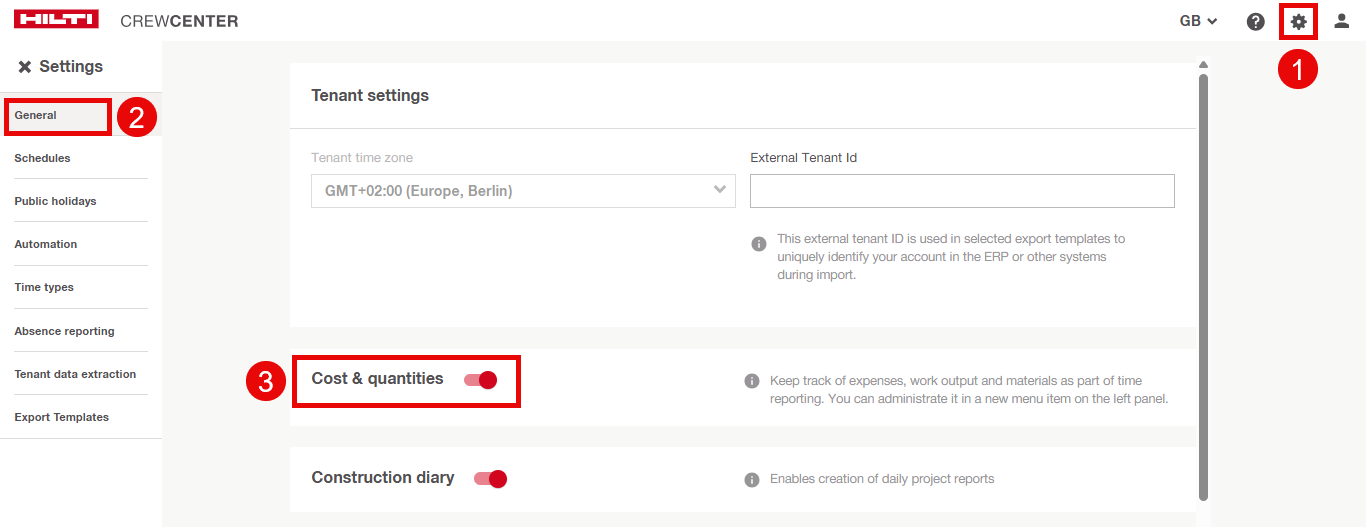

Enabling Costs & Quantities
Roles: Admin | Interface: Web
Administrators can turn on Costs & Quantities in General Settings (all related customer-facing elements disappear when the toggle is off). After it is activated, a new Costs & Quantities page appears in the navigation menu for Administrators.

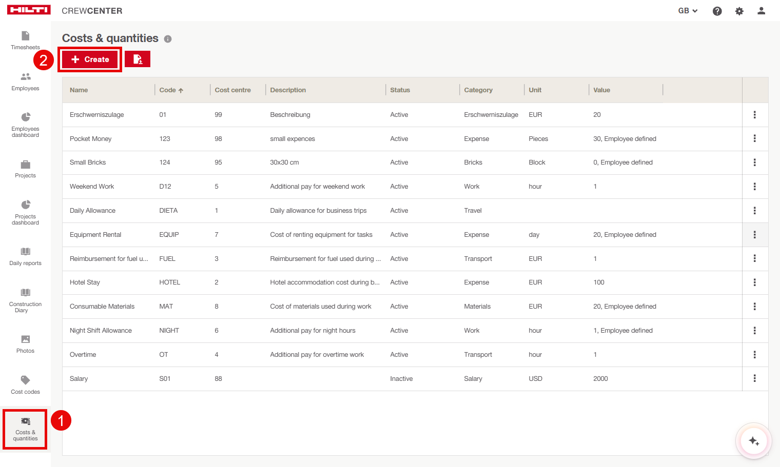

When the feature is enabled, Administrators will see a dedicated page "Costs & Quantities" on the left side panel, listing all existing expense and output types.
  1. Open the tab "Costs & Quantities"

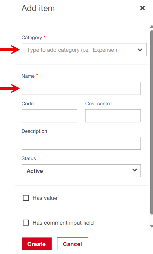

  2. Click Create at the top of the page: the "Add Item" panel opens as a side window.
  3. Enter the required information for the Cost or Quantity type, such as:
  • Name
  • Code
  • Category
  • Cost Centre
  • Description
  • Unit and value
  • Whether the type is an Expense or an Output
  • Additional settings (for example: comment required)
Note: Category and Name are obligatory fields.
If the cost has a value, the administrator should also specify the appropriate unit.
For example:
  • nights - for accommodation stays
  • days - for allowances or rentals
  • hours - for time-based work,
  • kilometers, miles - for distance traveled, kilowatt-hours (kWh) for energy usage
  • currency - for monetary values such as costs or labor wages.
Note: Value can have up to 15 digits before the decimal point and up to 4 decimal places
   4. Click Create to save the new Cost & Quantity type.

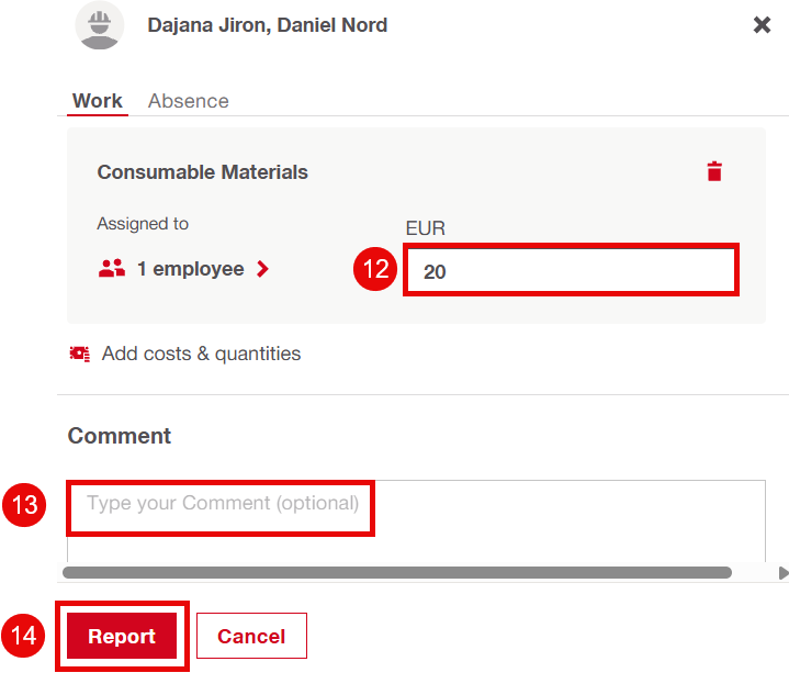

Adding Costs & Quantity to Timesheets in a multi user mode
Roles: Admin, Supervisor | Interface: Web
An admin and supervisor can add Costs and Quantity values to multiple timesheet entries at once, covering two or more days and two or more employees. Admins can apply these updates to all workers, while Supervisors can only update employees assigned to them and and themselves too.
To add timesheet entries at once follow steps:
  1. Go to Timesheets.
  2. Select two or more employees.
  3. Click Add Time Entry.
  4. Choose the days for which you want to add time, costs and quantities.
  5. Select a Project, then enter the Clock In and Clock Out times.
  6. Click Add Costs & Quantities.
  7. Choose the Costs & Quantities from the list.
  8. Confirm the selection.

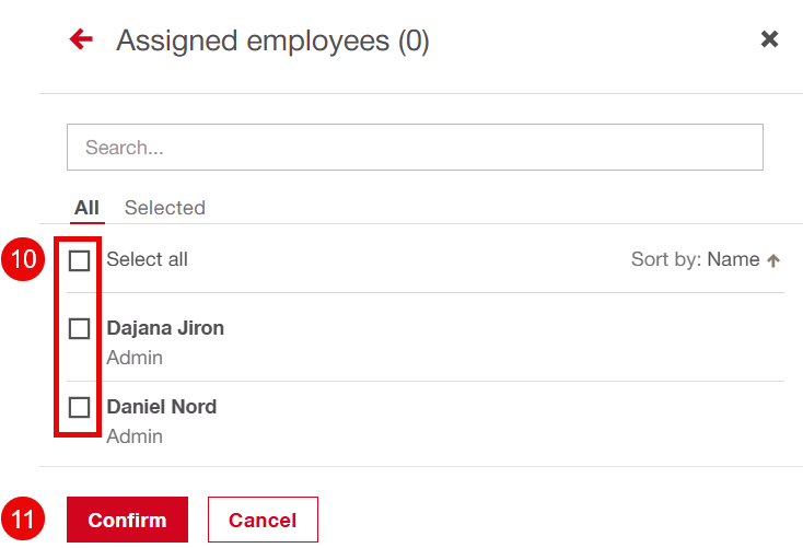

  9. Press "No employees" to assign employees. Here, the user can choose which employees to assign costs and quantities to.
  10. Select All employees or choose the specific employees from the list.
  11. Press Confirm.
  12. Adjust the values for the entry if needed.
  13. Add a comment if desired.
  14. Click Report to save.
Editing Costs & Quantity
An admin can edit Costs and Quantity on the Costs & Quantity page after they have been created.
If a given cost or quantity is changed, it will apply only to future entries; already saved timecard will not be affected.
To edit the Costs and Quantity follow steps:
  1. Go to the Costs & Quantity tab.
  2. Select the entry you want to edit and click the three dots (menu).
  3. Click Edit.
  4. Adjust the relevant fields as needed.
  5. Press Update.

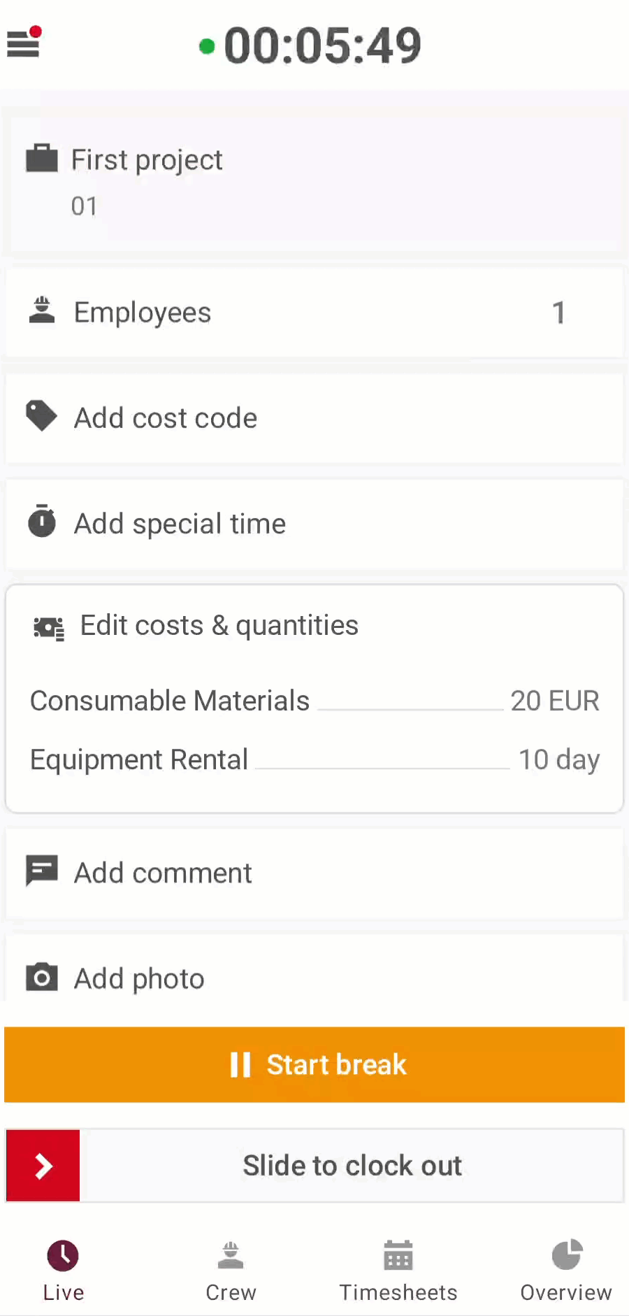

Adding Costs & Quantities on Mobile in the Live Mode
Roles: Admin, Supervisor, Employee | Interface: Mobile
All users can add costs and quantities on mobile. To do it follow steps:
  1. Clock In
  2. Select Edit Costs & Quantities.
  3. Choose one or more items from the list.
  4. Press Next.
  5. Adjust the quantities as needed.
  6. Press Confirm.
Costs and quantities are added and can be updated later as needed.

In live mode, the user can edit costs and quantities.
  1. On the Live screen, select Edit Costs & Quantities.
  2. To modify an existing cost, select the item you want to change.
  3. Update the value and press Confirm.
  4.  To add a new cost, press Add Item.
  5. Select the item from the list.
  6. Adjust the value if needed.
  7. Press Next, then Confirm.
