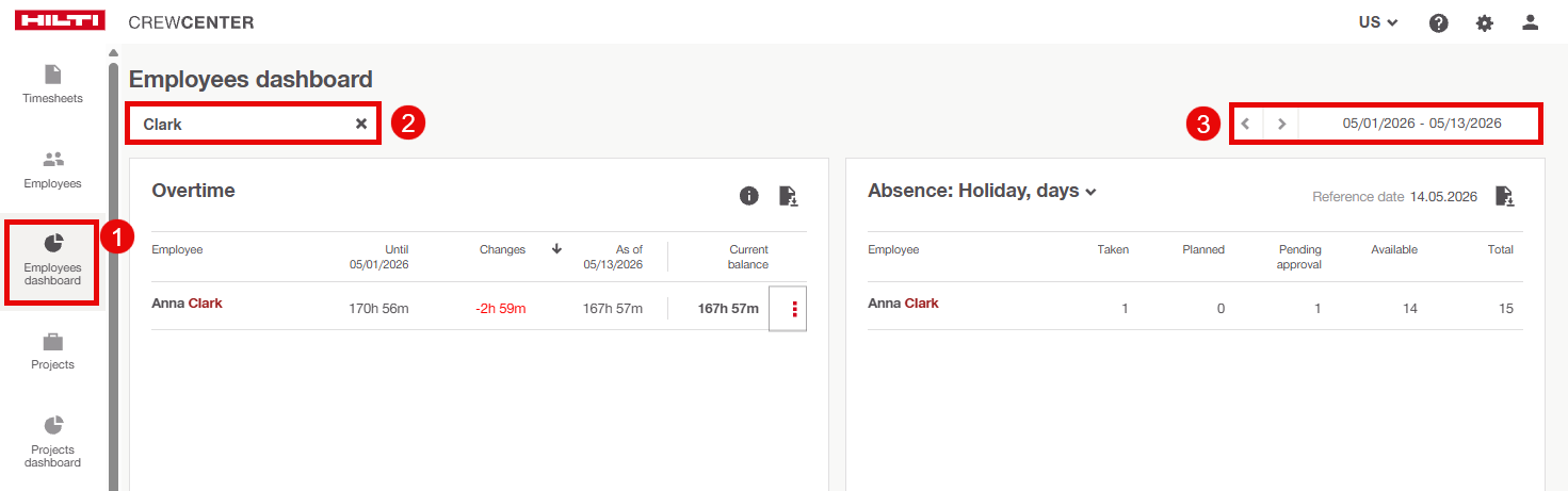

    Admins can view Overtime for employees in the Employee Dashboard. Supervisors can view Overtime for their crew.
    Follow these steps to view overtime details for an employee:
    1. Open the Employee Dashboard from the left-hand menu.
    2. Search for the employee or select them directly from the list.
    3. Choose the desired date range for your review.
    4. Navigate to the Overtime section to view the relevant data.

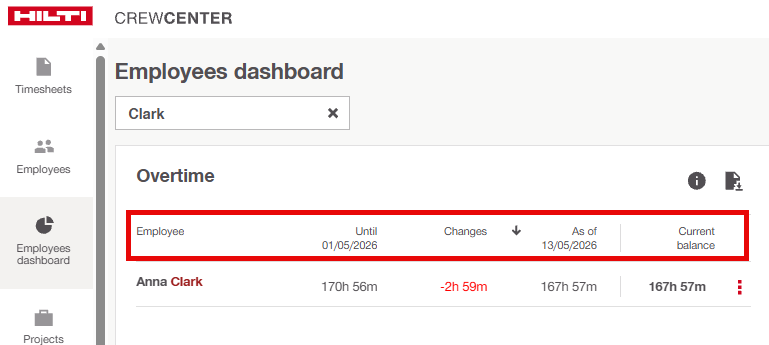

    In the Overtime section, you will find:
    • Employee Name – a list of all employees included in the report.
    • Until XX/XX/XXXX – a summary of the total overtime hours accumulated up to the selected date.
    • Changes - result of corrections happened between  "as of <date>" and "until <date>" (set new balance or Add/Subtract time) by the Admin
    • As of XX/XX/XXXX - the balance as of selected date
    • Current balance - the total overtime from the current year up to (and including) the previous day, regardless of the selected time frame. Today is not included.

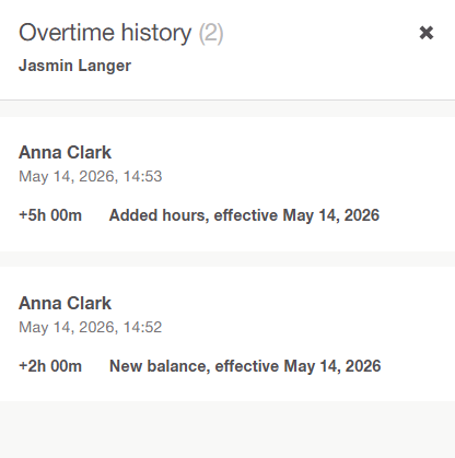

    View Overtime history
    Roles: Admin | Interface: Web
    Overtime history shows changes that impact an employee’s overtime balance, including manual corrections.
    To view the overview history follow steps:
    1. Open the Employee Dashboard.
    2. Find the employee.
    3. Open the employee’s menu by clicking the three dots on the right side.
    4. Select History.
    The History panel will open:
    The panel displays all manual adjustments made to overtime.
    Note: The limit for manual adjustments is 999 hours and 59 minutes.

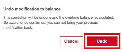

    How to undo a manual overtime correction
    Admins can remove a manual overtime correction directly from the Overtime correction history.
    To undo manual overtime correction follow steps:
    4. Select History
    5. Hover over the entry to reveal the Undo button.
    1. Confirm the undo action.
    The entry will be removed, and the employee’s overtime balance will be automatically recalculated.

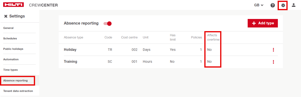

    Configure absences to affect Overtime
    Admins can set whether an absence type impacts the overtime balance.
    To do this:
    1. Go to Settings and select Absence Reporting.
    2. When adding a new absence, check the box in the last column. If unchecked, the absence won't affect overtime.

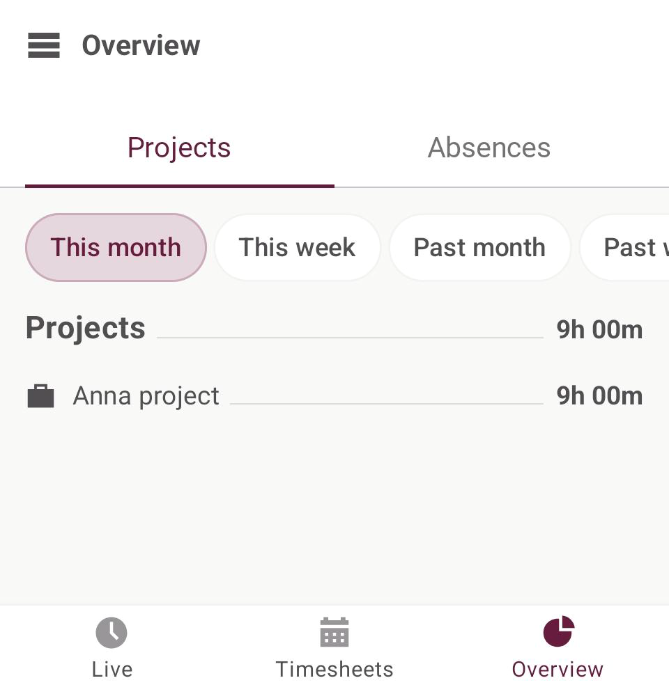

    Overtime is available on Mobile so users can see balances and changes.
    To view the overtime open the Overview tab on the mobile.
    Employees can view their own overtime divided into time period: This month, this week, past month, past week and specific (to set the custom range).
    On the Overview tab, Administrators and Supervisors can view employees’ overtime:
    Administrators can see overtime for all employees.
    Supervisors can see overtime for their assigned crew only.
    When selecting an employee, their overtime hours are displayed for the current week, previous week, current month, or a specified period.

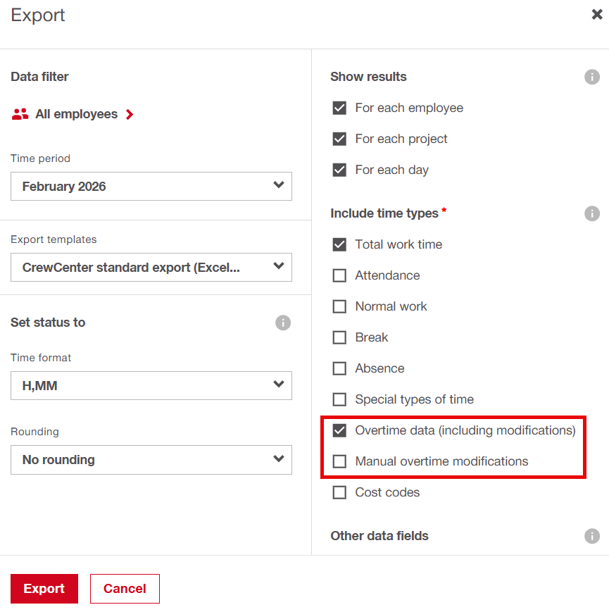

    4. Choose “Overtime data (including modifications)” and "Manual overtime modifications" if desired
    5. Click Export to confirm
    The file will be downloaded to your local computer.

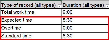

    In the Type of record column, three entries are added per day: Expected time, Overtime, and Standard time.

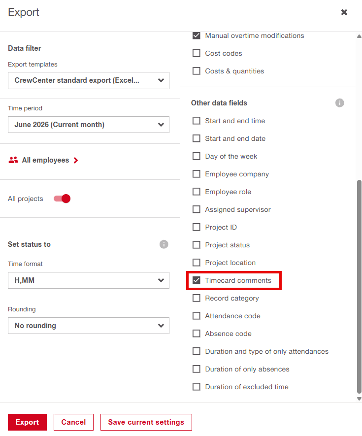

    Comments associated with manual manipulations will appear in the "Comment" column, but only if the user has selected "Comment" as "Other fields data" for the export:
    Comments will be added in the Comments column in the exported report:

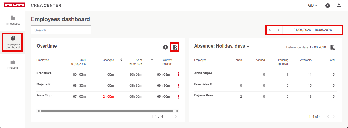

    To do this, follow these steps:
    1. Open the Employees Dashboard tab
    2. Select the desired time range in the top-right corner
    3. Click the export icon in the Overtime section
    4. The file will be downloaded to your local computer in CSV format
    The file includes the exact columns and data shown in the Employees Dashboard for the selected time range.
