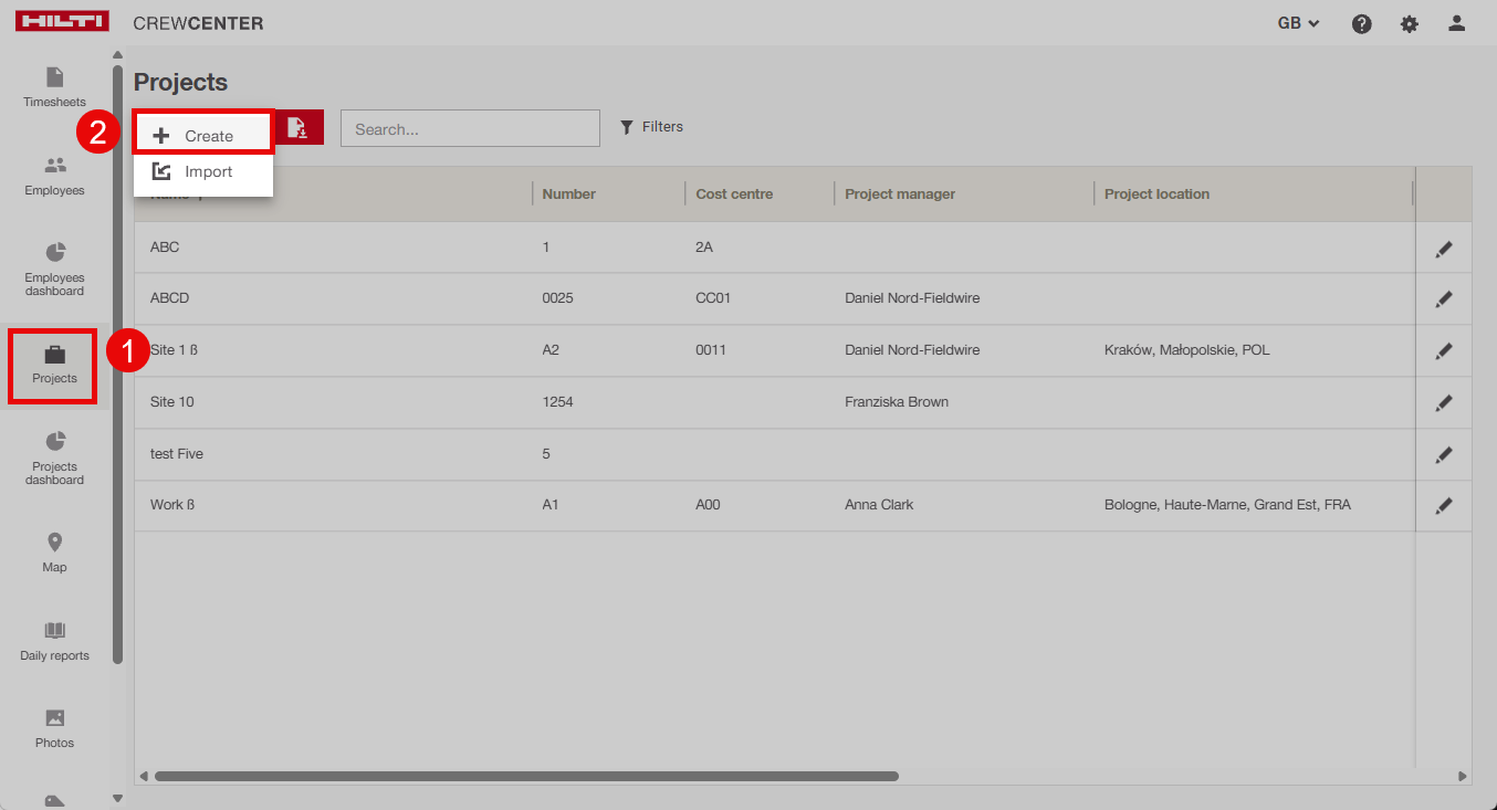

  1. Navigate to the Projects tab on the left side of the Web app.
  2. Hover over the "+ Create" button and select "+ Create".
