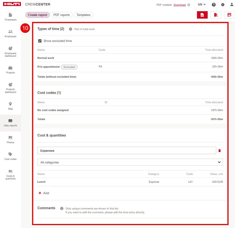

    9. Employee work hours and breaks are retrieved from recorded timecards. This section appears only when hours have been recorded, and it shows only the employees who submitted timecards. If no hours are recorded, the area remains empty.
      Note: The admin can choose whether to view all employees or only 12 at a time. This can be done by clicking “See all” or “Hide.”
    1. Employee time types, cost codes, cost & quantities, comments will be also retrieved automatically from recorded Timecards If no data recorded, the area will be empty.
    Note: Admins can distinguish between regular and excluded time entries in the Types of Time widget. Excluded entries are labeled accordingly, can be shown or hidden with a checkbox, and are excluded from the payable hours total.

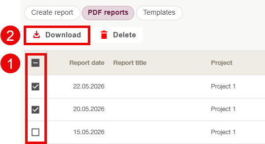

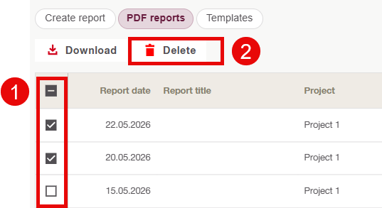

    Multiple reports can also be selected for bulk download as a ZIP file or bulk deletion with an additional confirmation step.
    To download PDF reports in bulk:
    1. Choose the PDF reports you want
    2. Click download.
    The PDF reports will be saved to your computer.
    To delete PDF reports in bulk:
    2. Click delete.
