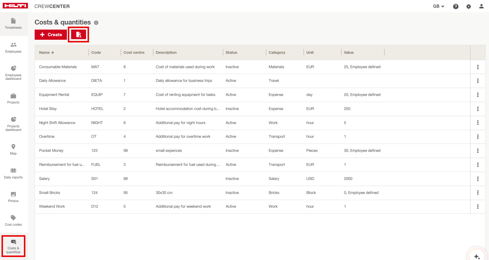

    When the feature is enabled, Administrators will see a dedicated page "Costs & Quantities" on the left side panel, listing all existing expense and output types.
    1. Open the tab "Costs & Quantities"
    2. Click Create at the top of the page: the "Add Item" panel opens as a side window.

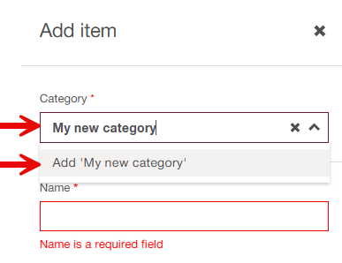

    3. Select the category from the list or type the new one. Then click "Add XXX" which will show up to add it.

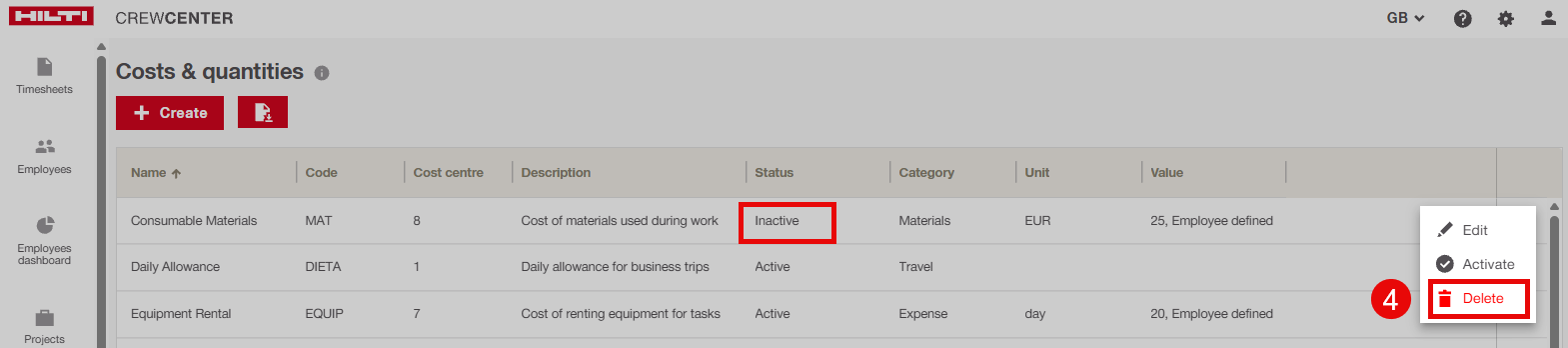

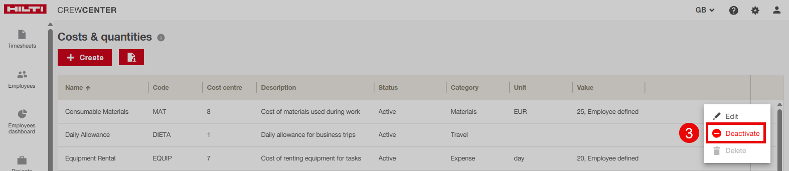

    Deleting and deactivating Costs & Quantity
    Roles: Admin | Interface: Web
    Admins must deactivate a Costs & Quantities (C&Q) item before it can be deleted.
    1. Go to the Costs & Quantity tab.
    2. Select the entry you want to deactivate and click the three dots (menu).
    1. Press Deactivate. The item became inactive.
    1. Select the Inactive line and press three dots. Choose delete
    2. Confirm the action on the pop-up window.

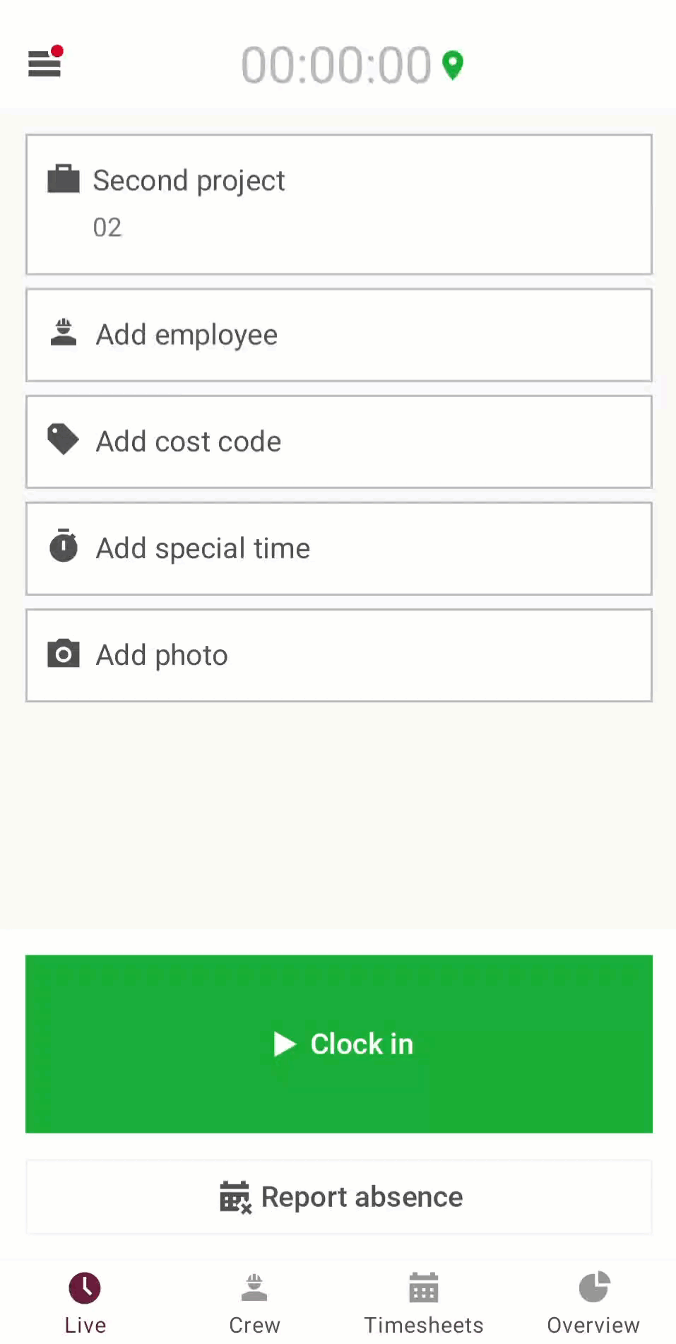

    Adding Costs & Quantities on Mobile in the Live Mode
    Roles: Admin, Supervisor, Employee | Interface: Mobile
    All users can add costs and quantities on mobile. To do it follow steps:
    1. Clock In
    2. Select Edit Costs & Quantities.
    3. Select one or more items from the chosen category.
    4. Press Next.
    5. Adjust the quantities as needed.
    6. Press Confirm.
    Costs and quantities are added and can be updated later as needed. The previously created entries remain unchanged.

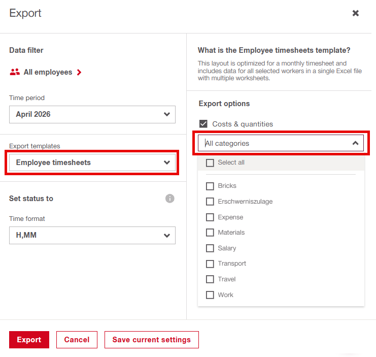

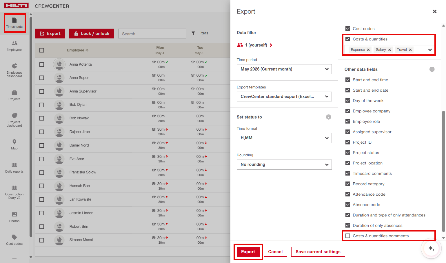

    Export Costs & Quantities
    Admins can export employee timesheets with Costs & Quantities data included.
    To do this:
    1. Go to Timesheets.
    2. Select Export.
    3. Check the Costs & Quantities option.
    4. Choose whether to include all categories or only selected ones.
    5. Choose whether to include Costs & Quantities comments
    6. Click Export to generate the file.
    Admins can also include aggregated Costs & Quantities (C&Q) data in Employee Timesheet exports by category.
    To do it:
    2. Select Export.
    3. Choose Employee timesheets export template

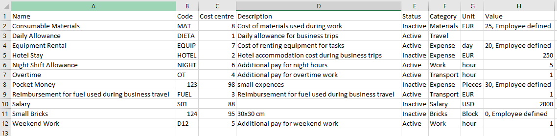

    It is also possible to export a list of all existing Costs & Quantities, both active and inactive. To do this:
    1. Go to the Costs & Quantities tab.
    2. Click on the download icon.
    Note: The file containing Name, Code, Cost Centre, Description, Status, Category, Unit and Value will be downloaded to your local computer in CSV format.
