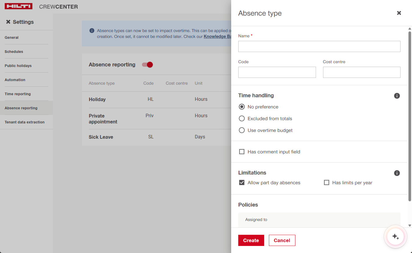

    • Define absence types that use a yearly balance (e.g. “Vacation 2026”)
    • Set limits for allowed time off and assign them to selected employees or groups
    • Can create or edit absences even if balances are low or limits are exceeded. The create/update button stays enabled
    • Decide if comments for a given absence type are required, optional or not allowed

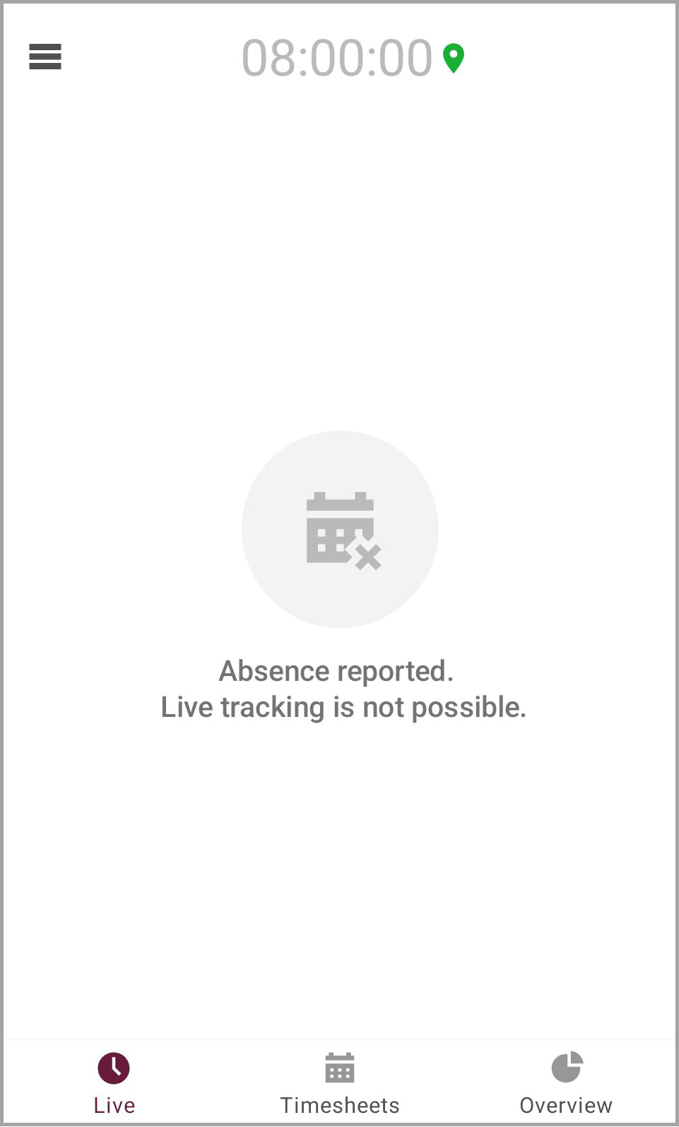

    When user reports an Absence the Live tracking is forbidden and user sees below screen:

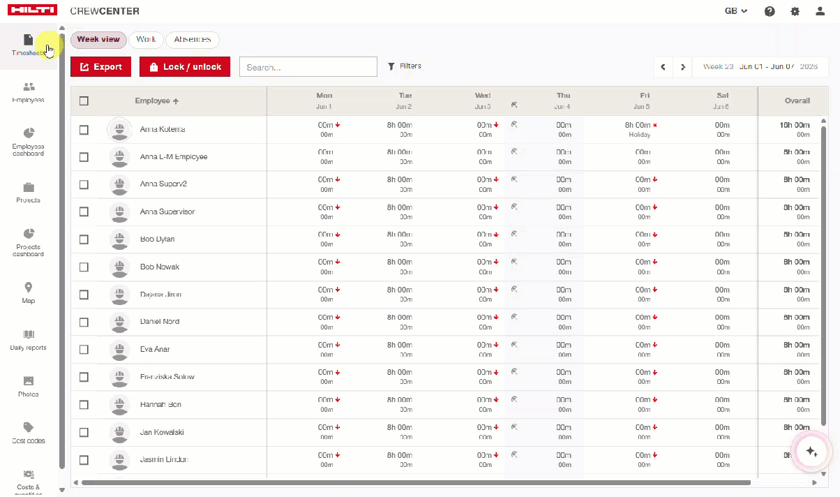

    Supervisors and Admins can manage absences in the Web App.
    To add or edit absences:
    1. Open the Timesheets tab
    2. Select the week for an employee on the top right corner
    3. Click on the selected day to view the summary of time entries and absences for that day
    4. Edit absences by clicking the three dots next to the absence
    5. Click update to save changes

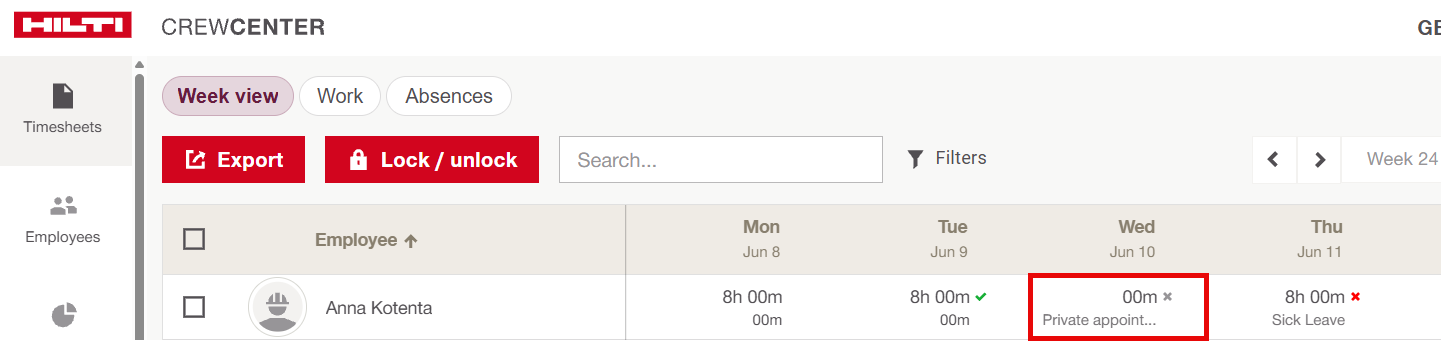

    • "Excluded" absence type do not count to the working time

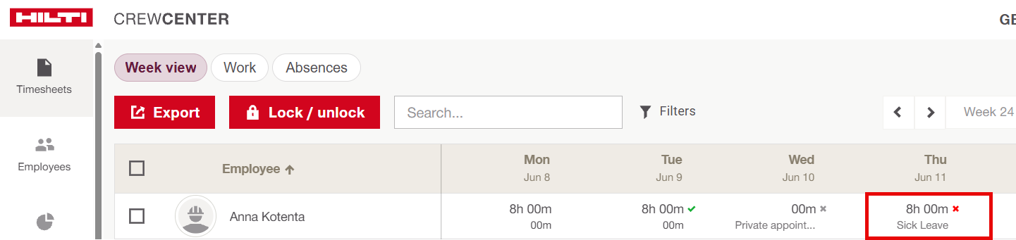

    When absences are excluded from working hours, a dark grey cross appears on the Timesheet day.
    When absences are included in the working hours, a red cross appears on the Timesheet day.
