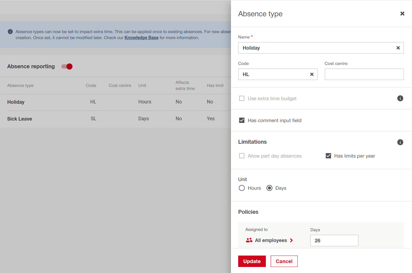

Admins:
  • Define absence types that use a yearly balance (e.g. “Vacation 2026”)
  • Set limits for allowed time off and assign them to selected employees or groups.
  • Can create or edit absences even if balances are low or limits are exceeded. The create/update button stays enabled
  • Decide if comments for a given absence type are required, optional or not allowed.
  • Configure absence settings (available only on Web).
  • When selecting multiple employees, admins see all assigned absence types, including those with limits. Limits are treated as guidance, not a hard stop for admins.

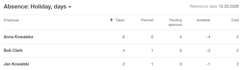

Employee Dashboard
A widget displays details about absences per user and type, highlighting:
  • Amounts already taken (before reference date)
  • Planned (after reference date)
  • Pending (not yet approved)
  • Available (limit minus taken and planned)
  • Total limit

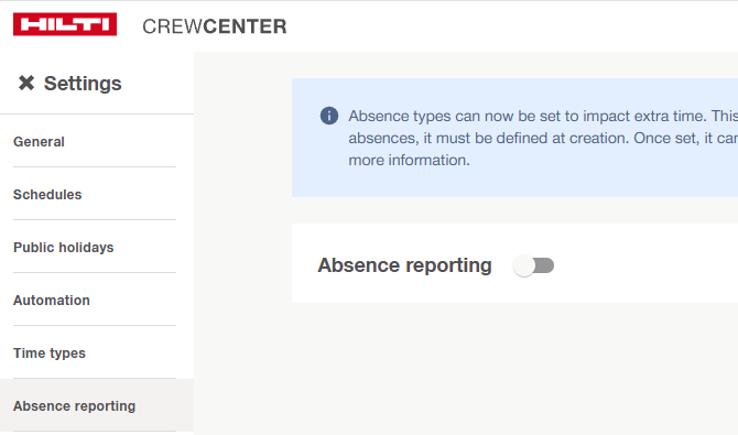

Absence Reporting Disabled: What Happens?
If absence reporting is disabled for your company or tenant in CrewCenter:
  • Users cannot create new absences (past, present, or future) on Web or Mobile.
  • The Absence tab and Absence buttons are hidden or disabled in:
    • Mobile: Add time report flows (Crew, Timesheets, Quick Actions)
    • Web: Timesheets views
  • Existing absences remain visible for history and exports, but new future absences cannot be added.
  • If you do not see the Absence option, it usually means absence reporting is disabled for your tenant. Contact your Admin for guidance.

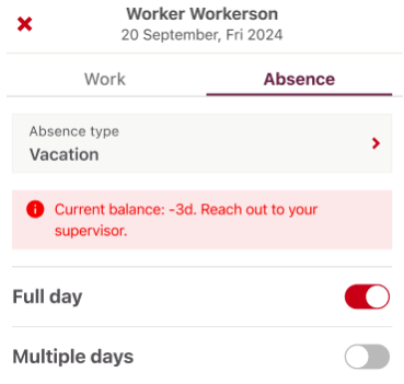

Additional information:
Employee can only create the absence when selected days are within the available balance.
For single employee, when a limited absence is selected, the app now shows the employee’s remaining balance.
