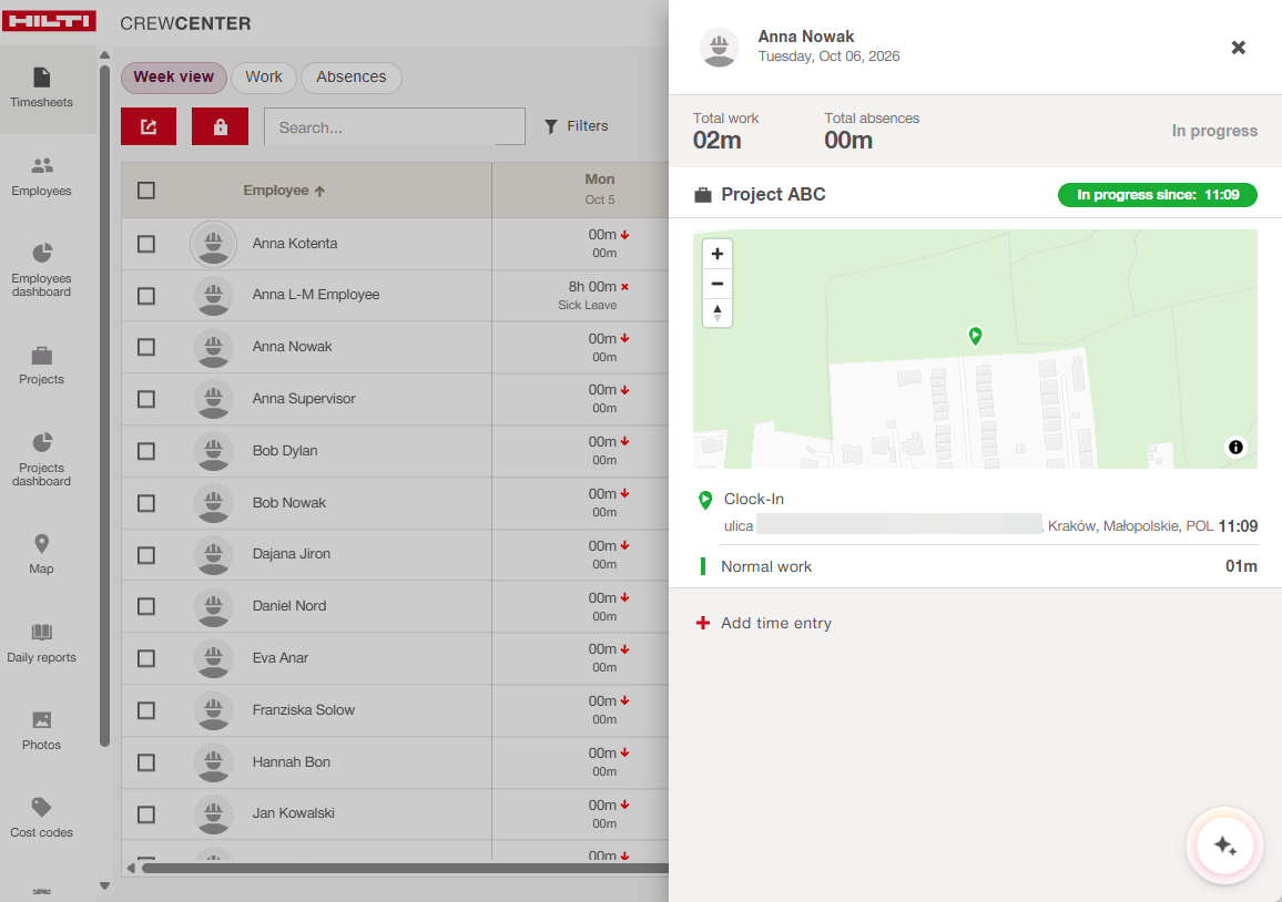

    Map Widget in Timecard Details
    A Map Widget in the timecard details panel shows clock-in and clock-out locations alongside the project location, helping approvers verify work locations and streamline timesheet approvals.

    There are three different coloured icons used to represent employee location events in CrewCenter:
    • Green icon: Indicates the location where the employee Clocked-In.
    • Red icon: Indicates the location where the employee Clocked-Out.
    • Grey icon: Means the app could not capture a precise location at the time of the event. This may happen if location permissions are denied or if the device could not provide a location.
