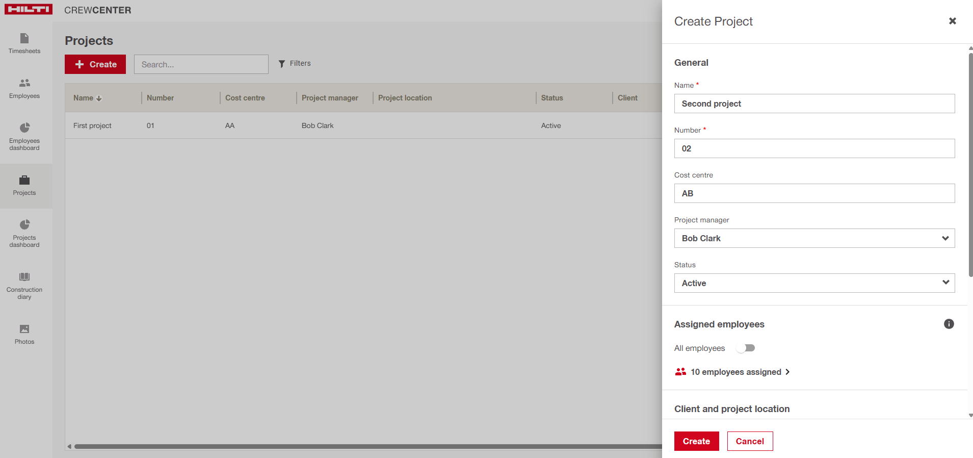

    1. Open the Projects page in the Web application.
    2. Click Create to start a new project.
    3. Fill in the mandatory fields:
      • Project Name
      • Project Number

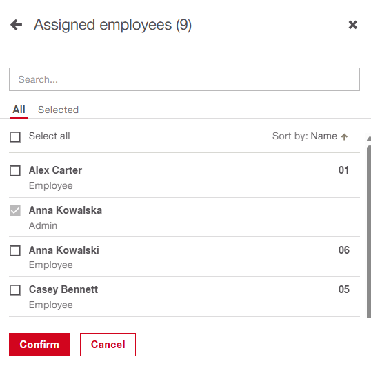

    1. Scroll to the Assigned Employees section and choose how to assign employees:
      • Assign all employees: Turn the Assign all employees toggle ON. All employees will be assigned automatically.
      • Assign selected employees only: Turn the toggle OFF. Manually select the employees you want to assign to the project. You can search by name or ID.
    2. Click Create.
      • Assign all employees: Turn the Assign all employees toggle ON to automatically assign all employees.
      • Assign selected employees only: Turn the toggle OFF, then manually select or unassign employees as needed.
