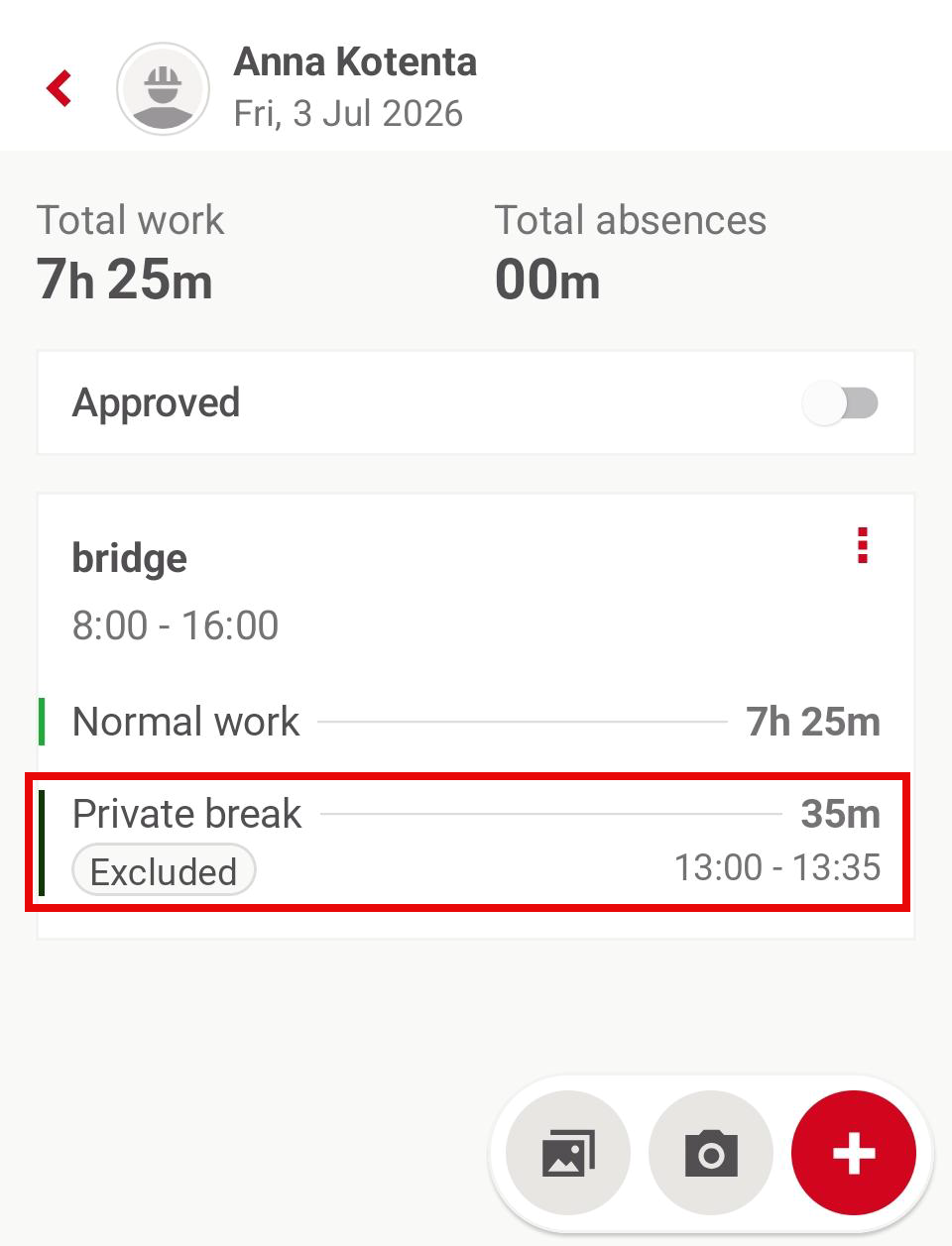

    How to use exclude time and absence from totals on Mobile
    Roles: Admin, Supervisor, Employee | Interface:  Mobile

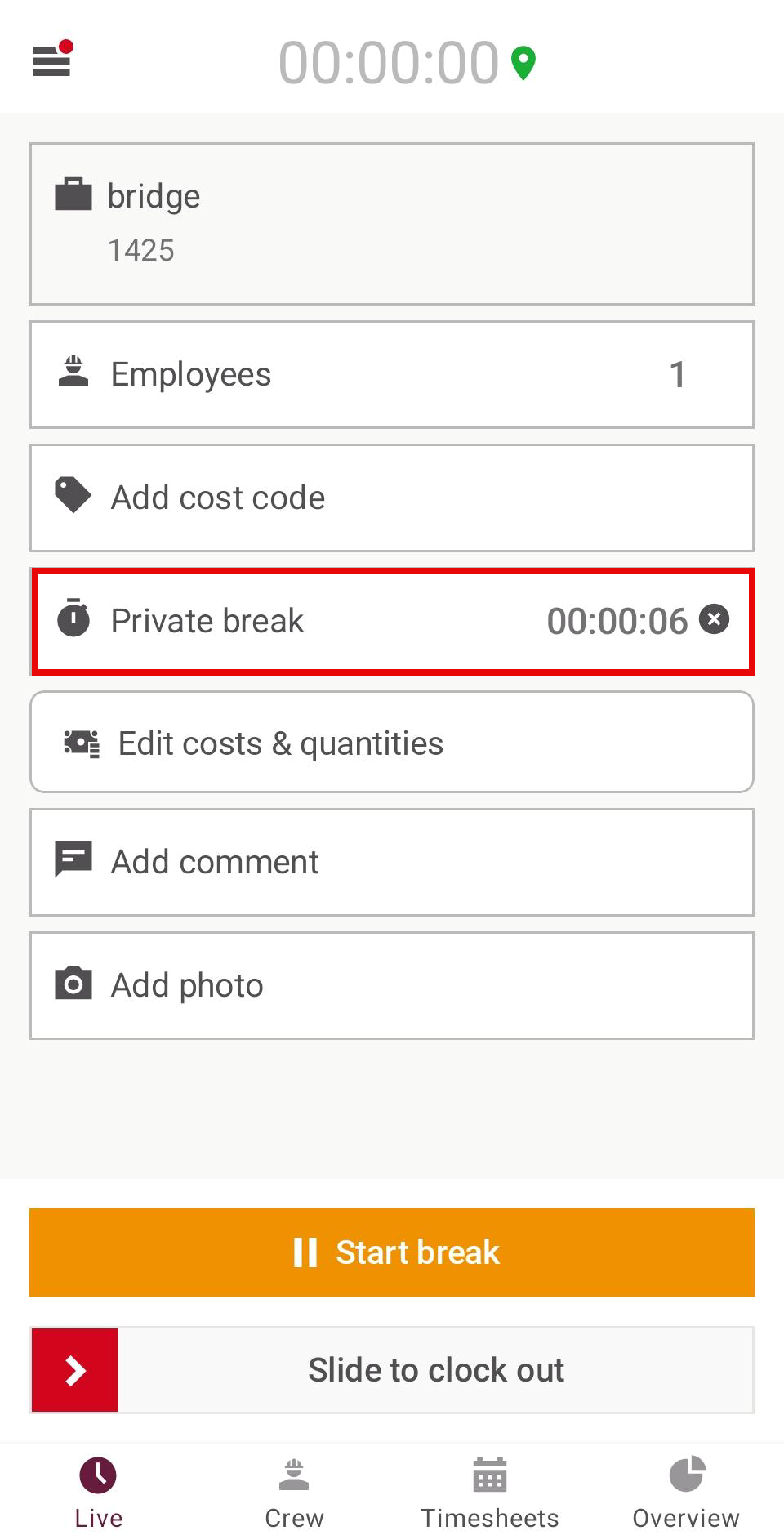

    Users can exclude absence time from their total during regular clock-in:
    To do this, follow these steps:
    1. Open the mobile app
    2. Select the special time that doesn't count as working hours
    3. Press Clock In
    To see if time is excluded from the total, check the timecard for the label "excluded."

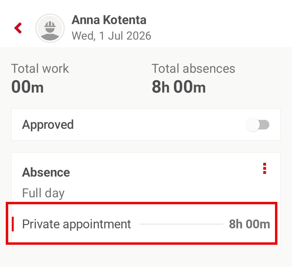

    To report the absence excluded from total:
    1. Go to the mobile and report the absence
    2. Choose the absence excluded from totals

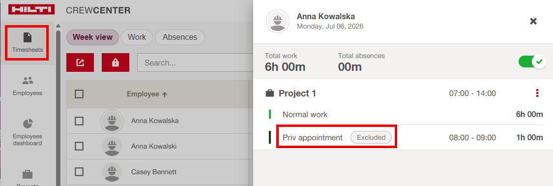

    How to use view excluded time and absence from totals on Web
    Timesheet view
    Roles: Admin, Supervisor | Interface: Web
    Admins and Supervisors can view excluded time and absence on Timesheet.
    To do this:
    1. Go to the Timesheet tab
    2. Open the employee's timesheet.
    3. Excluded time is labeled "Excluded".

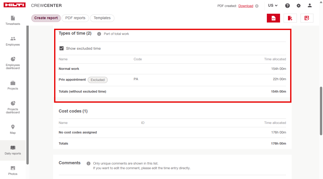

    Construction Diary (Daily Reports)
    Roles: Admin | Interface: Web
    As an admin you can see Excluded time in Construction Diary (Daily reports).
    1. Go to the Daily Reports (Construction Diary) tab, select the Project and date
    2. Go to the Types of time section
    3. Check "Show excluded time" to view excluded employee hours
    See more:  Construction Diary (Daily Reports) and Templates

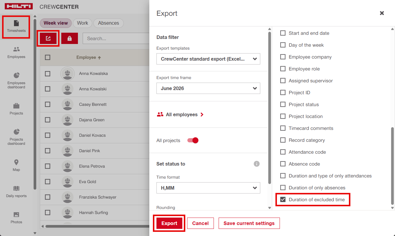

    Export Report
    To view excluded time in a report:
    2. Click Export
    3. Select CrewCenter Standard Export
    4. Under Other data fields, enable Duration of excluded time
    5. Click export to generate the report
    The report will then include the total duration of time entries marked as excluded from totals.
