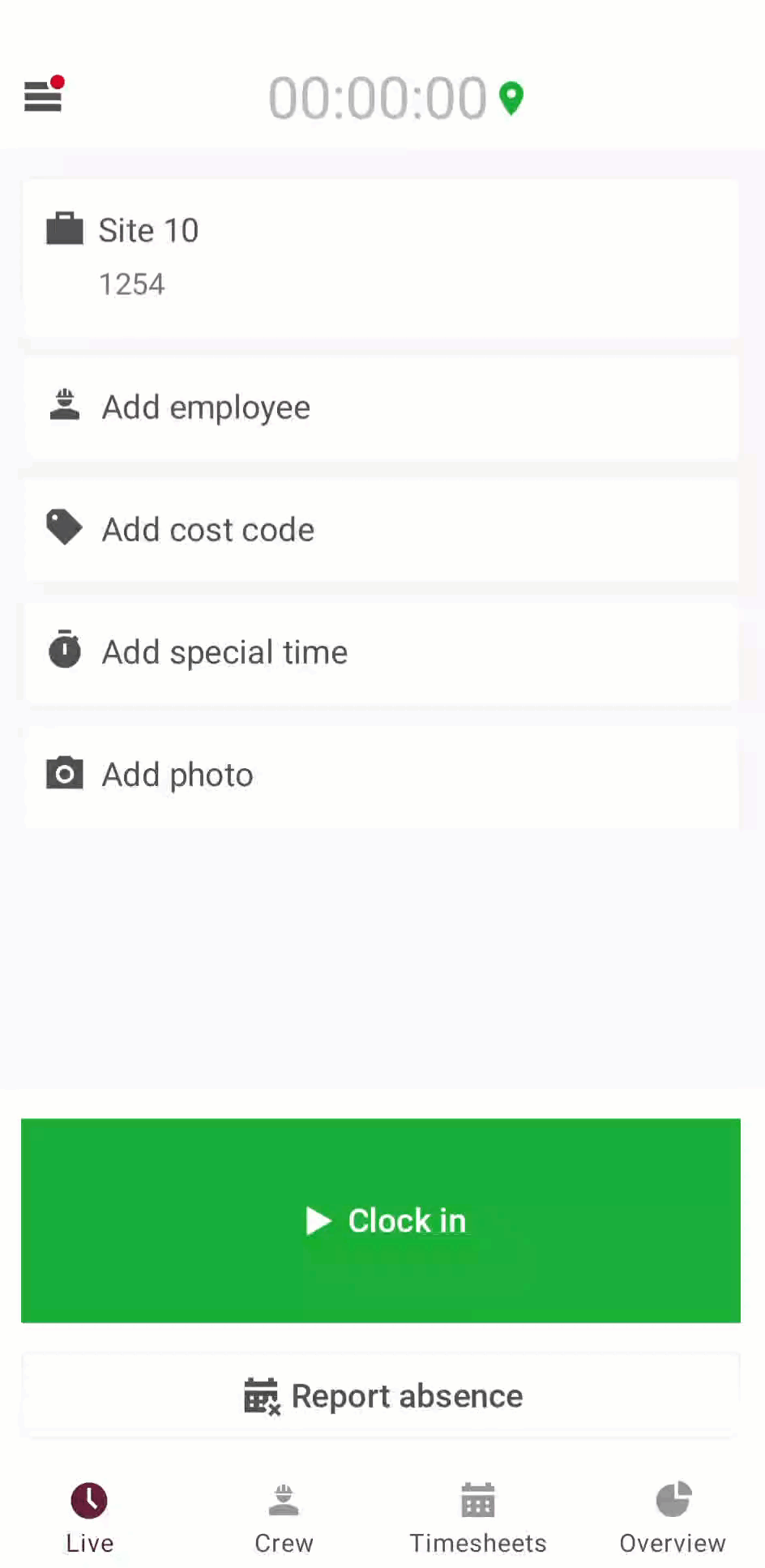

    Live Tracking Only Setting
    Roles: Admin | Interface:  Web
    Admins can enable a "Live tracking only" setting via the web app, restricting employees to track their working hours exclusively through live tracking via the Mobile App .
    To enable Live tracking only, follow these steps:
    1. Go to Settings (top right corner)
    2. Open the Time reporting tab
    3. Toggle Live tracking on
    When enabled:
    • Employees can only use live mode to start and stop their time - ensuring accurate, real-time data capture.
    • The ability to manually add, edit or delete time entries is removed for employees (Post mode -View only)
    • Absence reporting continues to work as before; employees can still report absences but cannot edit or delete them once created.
    When Live tracking is ON, the employee is unable to edit their work time. They can still report absences, but once created, they cannot edit or delete them.
    When Live tracking is OFF, employees are able to edit their work time, add absences, as well as edit or delete them.

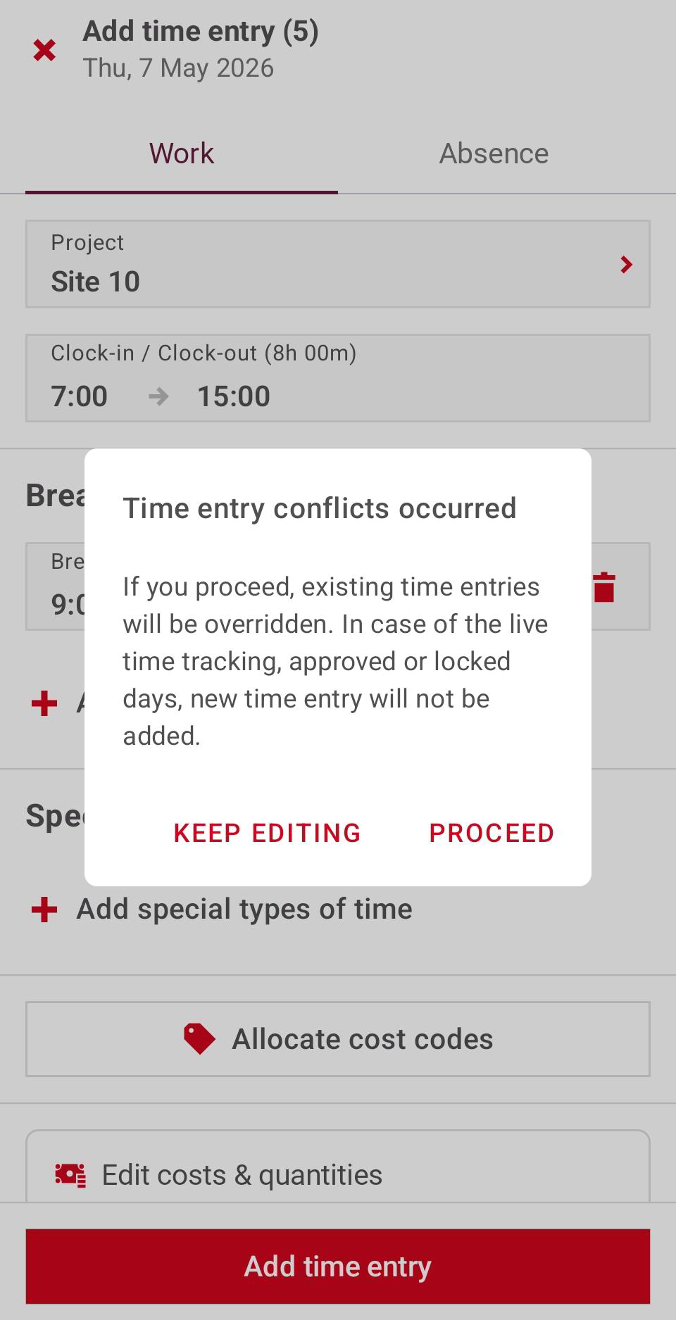

    If there are conflicts, user will see the pop up about the time entry conflict:
    User can choose to continue editing or proceed, overriding the previously entered work period.
    If one or more timesheets were locked or already approved user sees similar pop-up:
    User can skip or proceed, overriding the previous work period unless it is approved or locked.

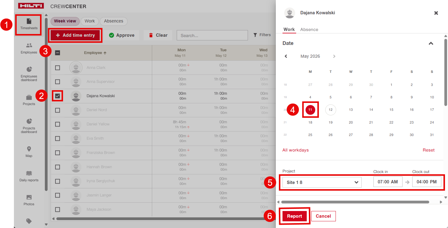

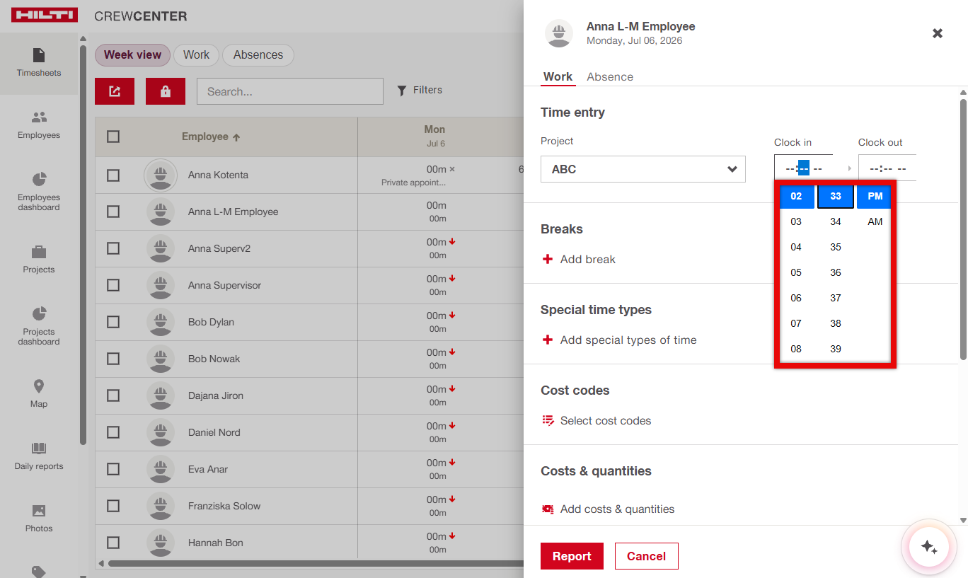

    How to add/edit time entries in POST Mode
    Roles: Admin, Supervisor | Interface: Web
    To add the time entry in the post mode:
    1. Open Timesheets
    2. Select the employee by ticking the box next to their name.
    3. Click Add Time Entry.
    4. Choose the required day(s) from the calendar in the side panel.
    5. Select the project, then enter the clock-in and clock-out times, add new one or change the existing one.
    6. Click Report to submit.
    Note: Selection is limited to the current month view; navigating to a different month will clear the selection.

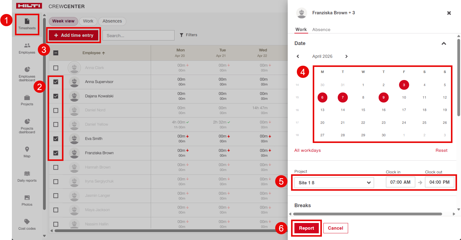

    How to manage time entries in POST Mode on WEB in bulk
    Admins and supervisors can bulk manage time entries in Post Mode on the web to save time and ensure consistent entries for all selected employees.
    To add the time entry in the post mode in bulk:
    1. Open Timesheets
    2. Select employees by ticking the box next to their name.
    5. Select the project, then enter the clock-in and clock-out times.
    6. Click "Report" button to submit.
    Tip: To open the clock-in/clock-out time picker, press the Spacebar on your keyboard. Then use your mouse wheel to scroll up or down and select the desired time.

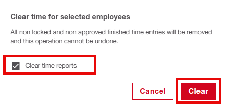

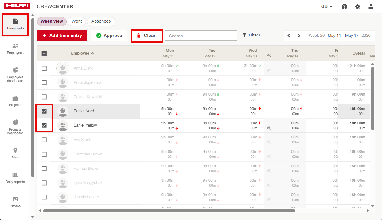

    How to delete time entries in POST Mode
    An Admin or Supervisor has the ability to select an entire week and clear the data for one or more employees, provided that the timesheets have not been locked or approved.
    To perform this action:
    1. Open Timesheets
    2. Select the employee (employees) by ticking the box next to their name.
    3. Click "Clear" on the top bar.
    4. Tick "Clear time reports" on the pop- up which display and confirm the Clear action.

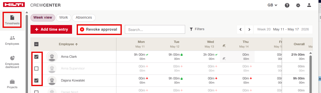

    If the timesheet was approved already click selected employees and hit "Revoke approval" on the top bar. Then perform the clear option.

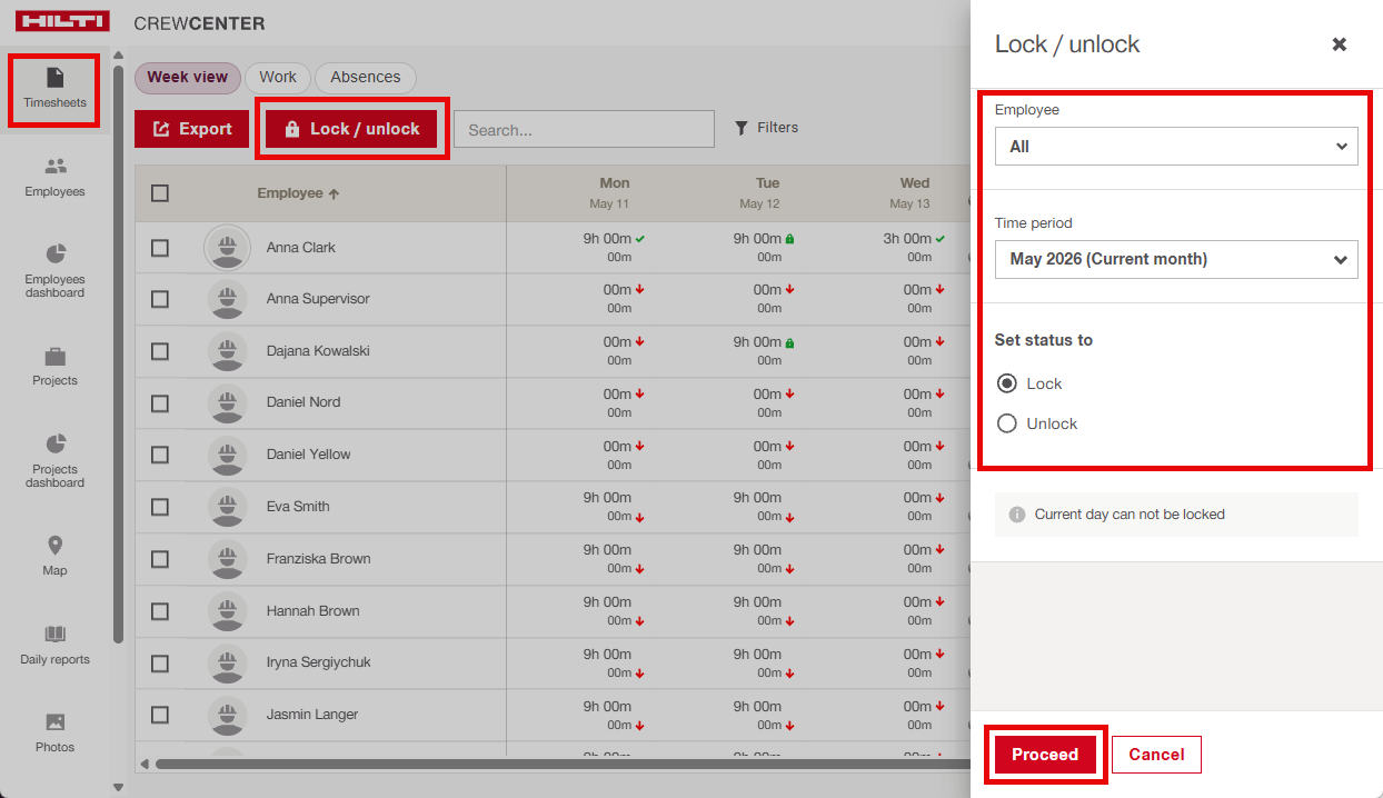

    How to lock time entries in POST Mode
    Admins can lock time entries and absences using the Web App. Locking prevents further edits or deletions until the entry is unlocked.
    1. Go to Timesheets
    2. Hit Lock/Unlock
    3. Select All or one employee
    4. Select the Time period (last week, current month or custom)
    5. Set the status to lock/unlock timesheets.
    6. Press Proceed.
    Note: Current day can not be locked.

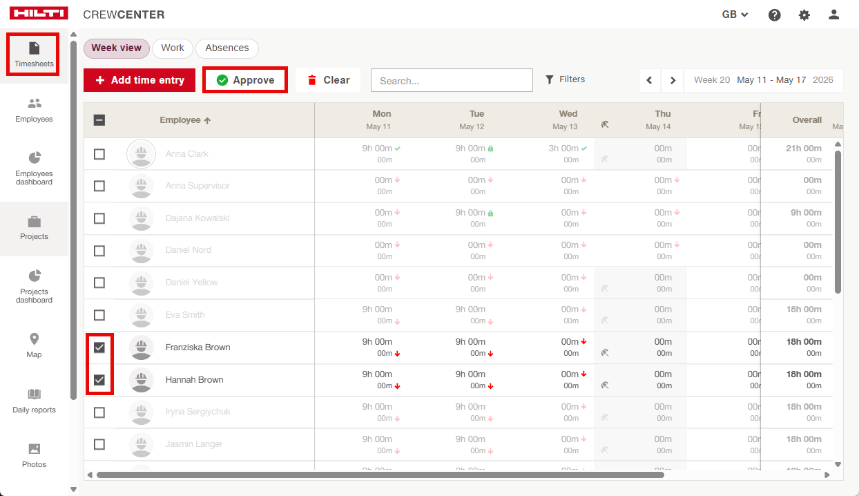

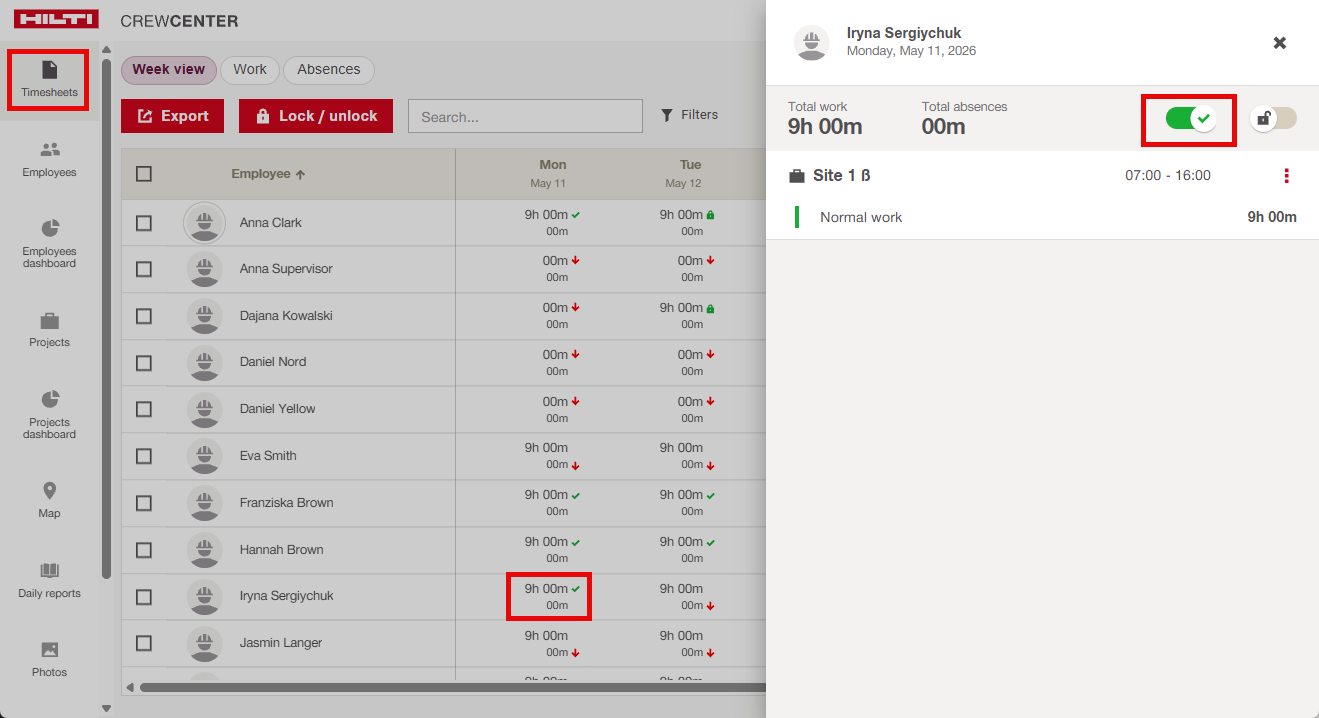

    How to approve time entries in POST Mode in bulk
    1. Open Timesheets
    2. Select one or more employees
    3. Click Approve
    The second option, to approve one timecard is:
    1. Go to timesheets
    2. Open the timesheets for selected employee for one specific day
    3. Toggle Approve button On.
