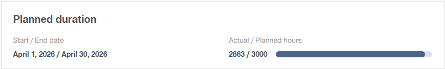

    Project Dashboard: Planned vs. Actual
    Roles: Admin, Supervisor  | Interface: Web
    A visual comparison of actual hours versus planned hours has been added to the Project Dashboard. This allows Admins and Supervisors to quickly see the project progress at a glance. The planned duration can only be set if the project includes a start date, end date, and estimated hours.

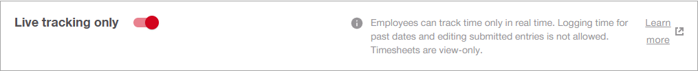

    Live tracking only (Upcoming feature with activation being rolled out until end of June)
    Roles: Admin, Supervisor, Employee  | Interface: Web, Mobile
    Admins can now enable a "Live tracking only" setting via the web app, restricting employees to track their working hours exclusively through live tracking via the Mobile App .
    When enabled:
    • Employees can only use live mode to start and stop their time - ensuring accurate, real-time data capture.
    • The ability to manually add, edit, or delete time entries is removed for employees (Post mode -View only)
    • Absence reporting continues to work as before; employees can still report absences but cannot edit or delete them once created.

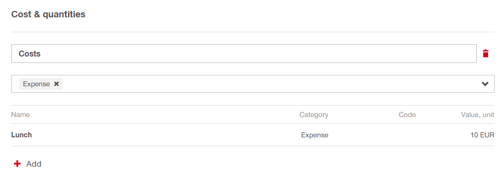

    Construction Diary - Costs&Quantities added
    Roles: Admin, Supervisor| Interface: Web

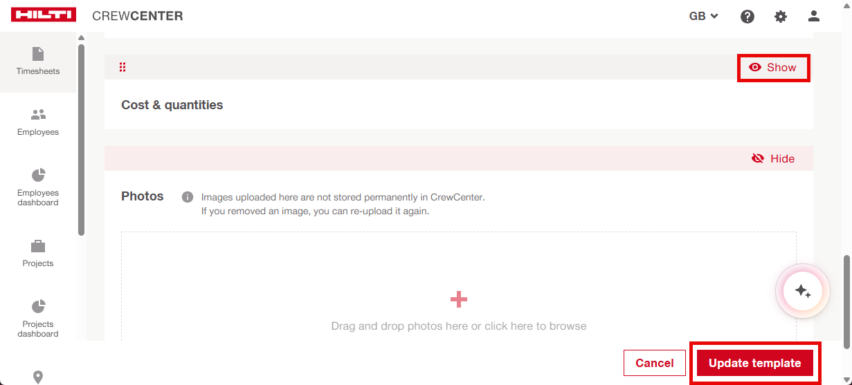

    Admins can now add a "Costs & Quantities" widget to Construction Diary templates. This allows for the tracking of expenses and materials directly within the diary. You can add multiple blocks with specific category filters (e.g., one for "Materials" and one for "Expenses") to customize the report for different project needs.
    Note: To view Costs & Quantities on the daily report, please make sure this is enabled in the Template:

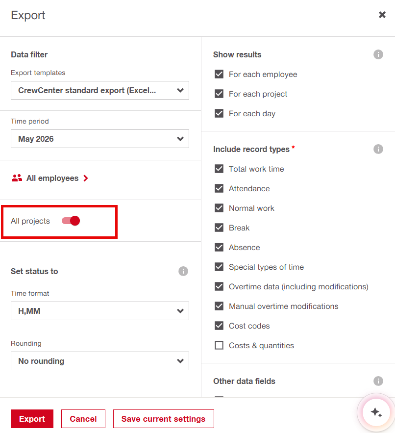

    Export Filtering by Project
    Admins and Supervisors can now apply a Project Filter to exports, enabling reports for specific projects instead of the whole account, simplifying project-based accounting.
    Note: "Employee timesheet" remains unchanged as it already provides full coverage of the monthly records for each worker, regardless of the project.
